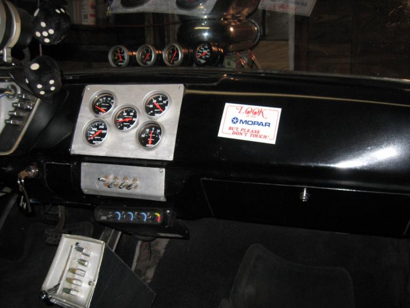

I've had manual reverse for 40 years and I use my thumb to shift now!:blob1:
