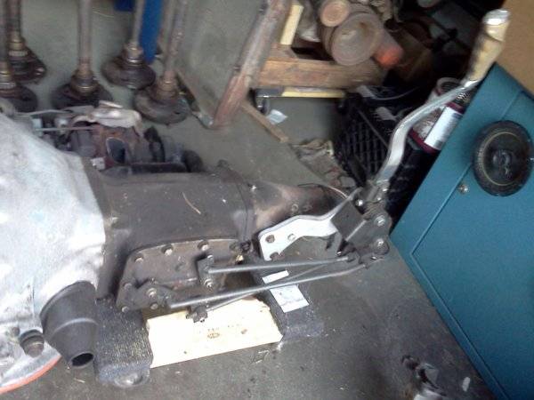

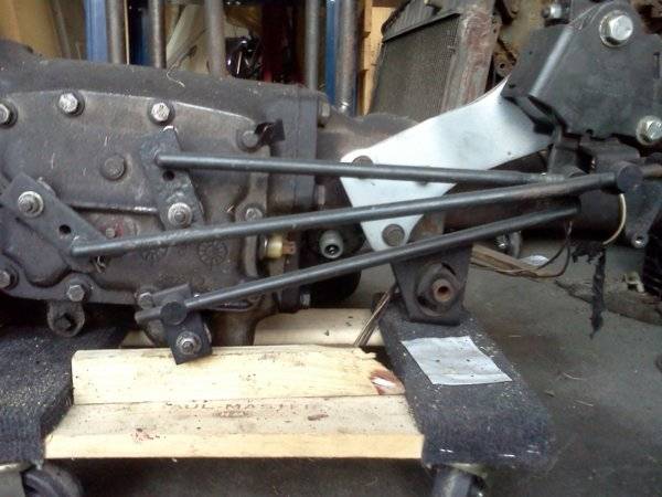

I've got a Van 833OD in my '68 Charger. The van shifter mounting plate was a piece of steel that put it high and forward of the B-body mounting holes. I have the correct shifter mount now, the van rods/levers, and a set of the aftermarket zinc-plated 68 B-body rods/levers. I can't get a combo to work without cutting/welding/bending. Who has pics of what they finally settled on? The only one that works close was the 3/4 inverted with the rod straightened out for less offset. The other 2 are being a pain.

Yeah, 3/4 is upside down, and I made that one work by flattening the bends to get the offset inboard/outboard correct. The other 2 rods in the aftermarket kit seem to have the offset backwards, but the length correct. I can solve it with a torch and a vise, but I can't be the only one to have this setup mounted in a '68 B-body (close pad, short rods). My van rods are too short since it was mounted up higher, closer, and rotated forward.

Here's mine-
I have the set from the van, which is close, but obviously wrong for the B-body shifter location, and I have this set...
https://www.yearone.com/Product/chrysler-b-body/sr687
The Y-O rods use plastic bushings and cannot be mixed with the factory transmission levers. The long rod works now that I have flattened it to reduce the offset to about 1/4". The other two would only work if I REVERSED the offsets completely. It looks like the only solution is a torch, but it makes no sense to me... Why is a replacement set so far off and still being sold, or does the van shifter just use a LOT less offset?
