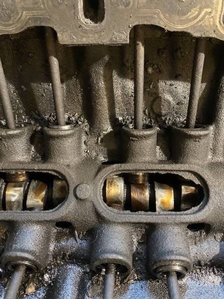

So I got this 1973 charger with the original 318 and 727. No, it does not have a smog pump nor does it have any of the smog ports on the heads, But the car sat for the better part of 30 years. I had it running and driving but I went to replace the intake manifold and the cam was absolutely destroyed (pic included). I bought everything to replace the cam the right way (timing chain, lifters, cam bearings), and the cam I bought has similar specs to a 340 cam because I’ve read it’s a nice mild cam, But I don’t know if I should just replace the valve springs on the original heads or just get new 360 heads? Or what goes into putting a new set of heads on a motor. I’m a very young motorhead, still learning a lot.
To be honest you should consider a complete rebuild. That motor looks dirty and all that cam debris is now in the oiling system. My bets if you pull the pan you will see more warn parts.
A "bitch slap" of reality really sucks to receive but sometimes......the actual truth will save you a lot of trouble down the line.
Pnora above may be right, he may not. The lifter valley does look dirty though. All that crud does fall in and land in the oil pan. From there, there is a suction pipe with what looks sort of like a shower head on the end. That is the "oil pickup" and it draws in oil to send it throughout the engine. The problem is, when crud falls into the pan, it sometimes gets into the oil pickup and blocks oil flow. That is bad.
The 318 engines can be made to run strong but you have to know the limitations. They were built with really low lift camshafts and soft valvesprings. They also had small valves in the heads until 1985 or so. Think about the intended applications the 318 was used for: Basic transportation with a huge priority of reliability. My opinion....the 318 was the Mopar version of the Honda civic 1.5 or the Toyota 22R. The 318 will run and run a long time but they are not a performance engine when they are kept stock.
A 340 cam with matching valvesprings AND a decent set of heads will really wake up a 318. The 340 from 68-71 was "rated" at 275 HP while the same 318 was closer to 150 HP.
If the car were mine, because I LOVE to save and rescue things.....I'd pull the oil pan. Clean out the lifter valley of all loose debris. Clean the oil pickup if it has any stuff blocking the screen. Reinstall the oil pan using Superformance gaskets and The Right Stuff sealant.

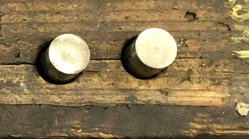

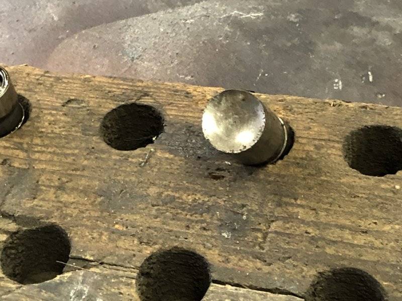

The cam may look dirty but still be okay. You can pull out one lifter at a time. Any lifter that looks like THIS is bad:
That bowl like dish you see indicates a failed lifter and surely the cam lobe it was riding on. All it takes is ONE lobe to go bad to warrant a cam and lifter replacement. This is a big job for a new enthusiast. I'd strongly suggest you find a friend that knows engines well enough to help you out. There are so many small details to know, it can be difficult to walk you though all of it from here.
If all the lifters look like these....
Flat across the bottom, your cam might be fine. Lifters actually have a very slight dome to them...we call it crown.
When running, the lifters have to spin to protect themselves and the cam lobes. A lifter that does not spin will soon wear out the bottom and the cam lobe too.
I pulled out as much garbage as a could from the top using shop towels, but I still plan on pulling the motor soon to drop the pan as well as inspect everything
Another option I’ve been thinking about is theirs an 80s 360 for sale for $500, guy says it runs good and has compression. But buying that motor might just puts me in the same boat with a different platform. If it turns out the cam on my 318 needs replacing, I might just put another stock 318 cam into it because I’m not looking for huge power out of this motor, I just want it to run and drive. Also would oil pressure reflect a clogged pickup screen, Because the car has always had good oil pressure?
I think what trashed the cam was when I first got the motor to where I tired to start it, I only primed the oil from that bolt under the distributor. And when it first started it shot to 4,000 rpms because a butterfly was stuck open on the carb.
