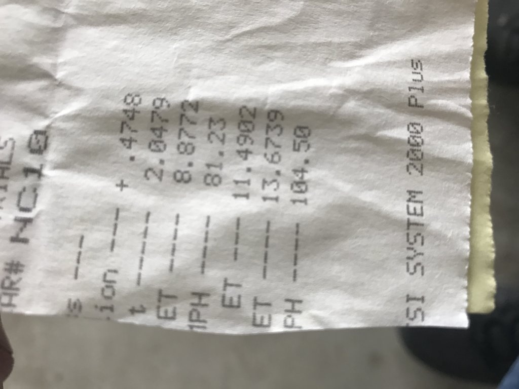

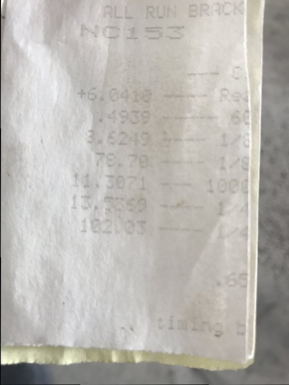

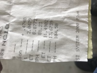

Here's 2 of the slips [email protected] & [email protected]
Street tires spinning off the line 3.91 gear 727 with a shift kit 2800 stall

I have some faster ones at the shop I'll check them when I get over there
Thanks. Don't go out of your way though. I was thinking the MPH will be a good indicator of ET potential for the OP when he starts making passes. He'll probably need 105/106 mph to reach 12.90's? Meaning, new car combos and 60 foot times usually aren't dialed in at first, but the speed can be there.
Think you're pretty close 105-107mph will probaly break into high 12's
