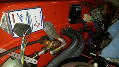

FBO ignition systems. I've had mine on since 2012 absolutely zero issues. He curves them for your build, you just tell him what you've got and he does the rest. Car starts right away every time and no big *** ugly red boxes in the engine bay. Distributor looks just like a stock one.
