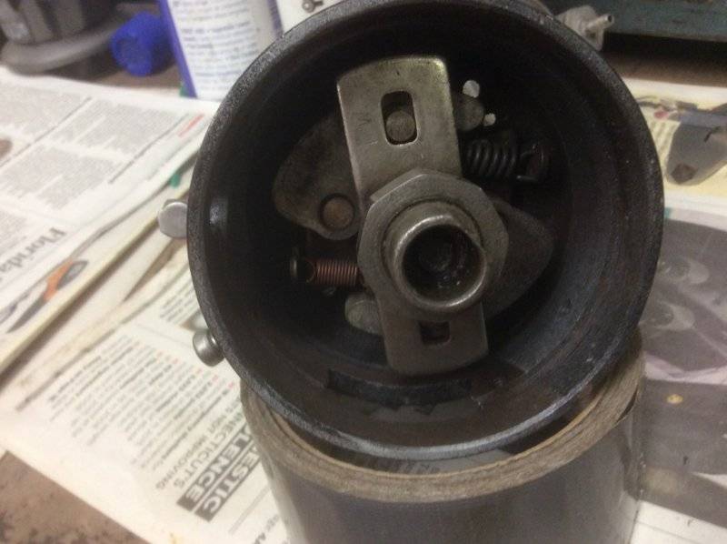

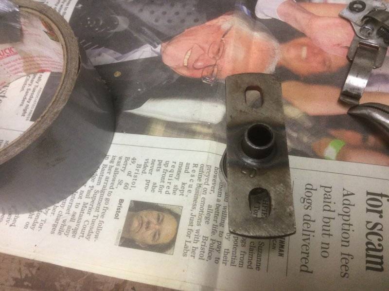

So then that cam stop should be an eaxact swap into the dual point that I've been messing with?
