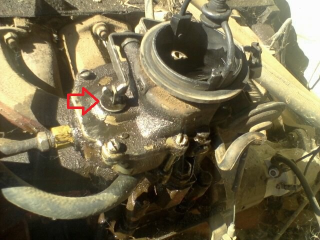

when i turn the key over to start it gas starts spewing out of the carb where the arrow is, i dont know what the problem is and/or how to fix it. any help would be nice :)
(This might be a simple fix but im only 17 so i dont have as much knowledge as most of you on this kind of stuff)
that is a bowl vent.gas comming out of there means your float is sticking open.carb prob needs rebuilding,not too hard to do with basic mechanical knowledge on a tiny carb like yours.check and see if you can get a kit at a local auto parts store.you may need to take the carb with you to get the right kit.you could also find someone to rebuild it for you.
stuck float. less than 20 bucks for a kit easy as a lawnmower to repair.
oh yeah if it has done much of that change your oil! because it will be full of gas oil in gas = dead engine
