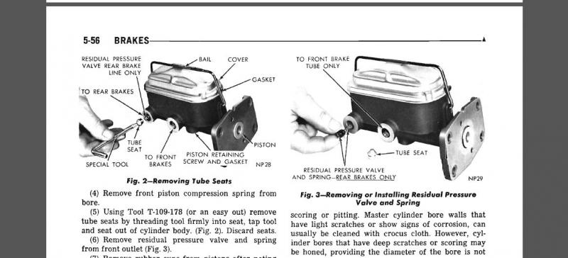

Pretty much all Dorman, Raybestos, Bendix, Cardone or other factory style disc/drum master will have the residual valve built into the drum port of the master. I haven't run into one yet that hasn't. But, never the less, things could be changing, so check **see pic below**. The more flashy Wilwood, SSBC, Baer ect..ect... that have limited masters designed to cover a broad range of applications may not, being they're going with masters that could be used in a disc/drum or disc/disc application. They leave that responsibility to the customer and will be spelled out in the installation directions. Do not install a 10lb residual valve for the rear's if you do not know, especially if you're going with the more off-the-shelf factory styled disc/drum stuff (being they should have one).
Here's a clip from the FSM showing residual valve location and removal:
Bottom line is to contact your brake/caliper MFG. Without knowing caliper volume to figure out M/C requirements, one would be guessing. On a larger 4 piston set-up you may need all the way up to 1 1/8". Obviously someone chiming in that has a similar, well working set-up would be pretty nice as well. Also, depending on the route you go with the M/C, ensuring you're not piggy-backing one residual valve on top another in the same circuit needs to be squared away. Good luck.
