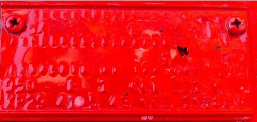

According to the website it's: XP29F8G25XXXX,
I've been able to decode it as noted below but after that I don't get it as the numbers seem out of wack, so I'm hoping it's a typing error on their part
X = Charger
P = Premium
29 = 2 Dr Hardtop

The vin# is not on that plate in 1968. the first four digits are xp29, some numbers are the engine code,trans code, production date, then lastly the Sequential order number. The plate is so painted over I could help with more if I could read it better.car is a 318 car with 904 transmission.
F=318 2 barrel, 8=1968, G=St. Louis Assembly Plant
I cant really make out much of the fender tag either. They really laid the paint on there
