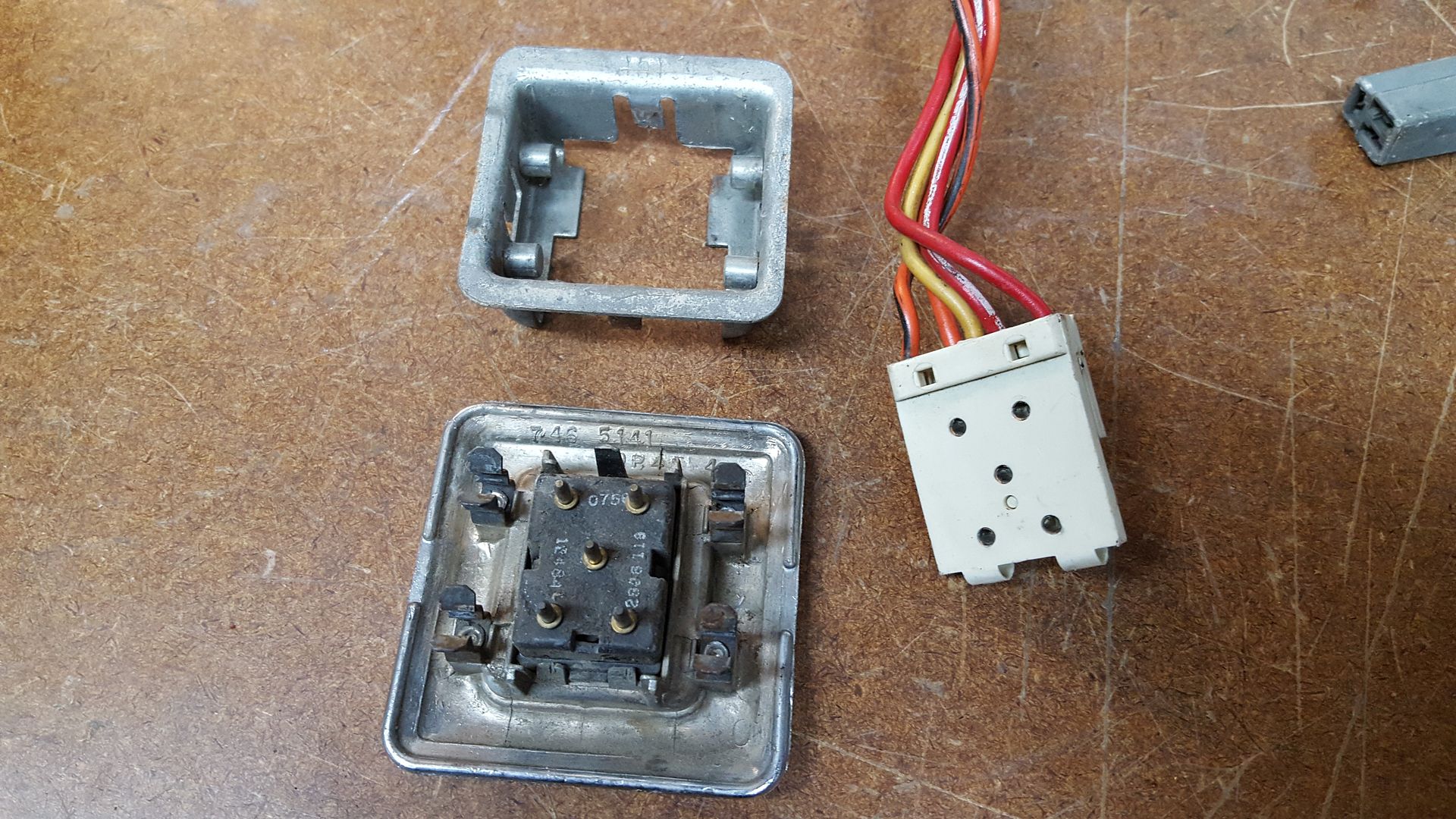

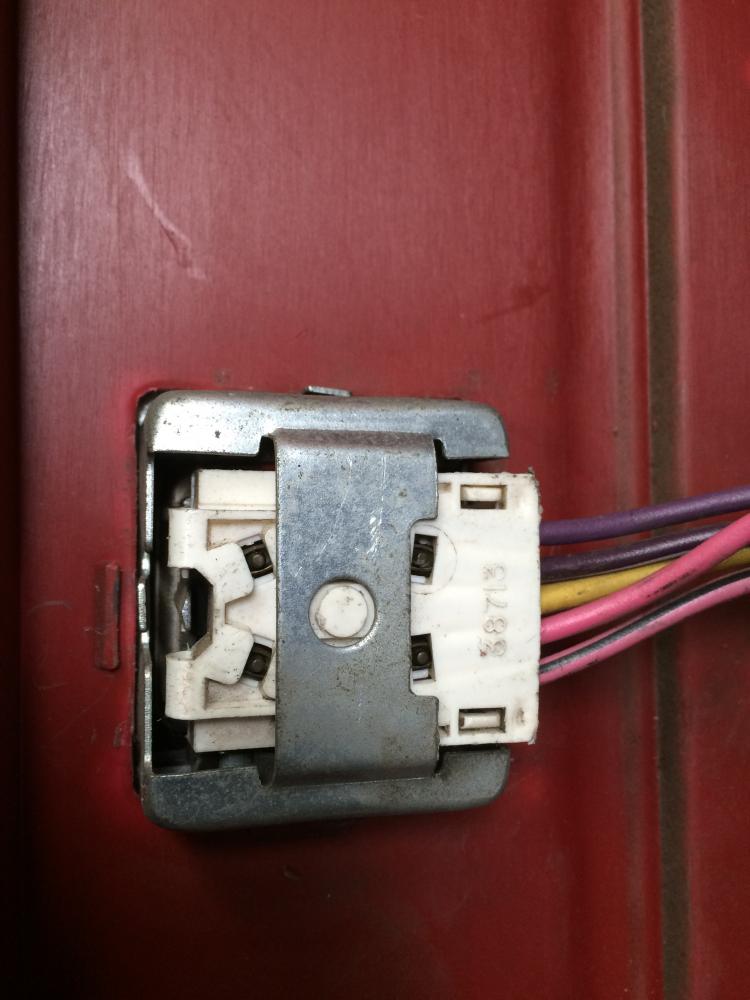

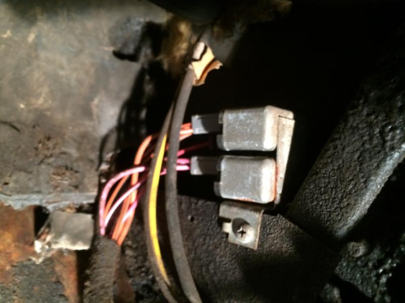

Plan to remove the right door panel, but I'm not sure about removing the switch from the door panel. It will not fit through the mounting hole.
1. Remove the harness from the lower kick panel. Pull harness back into door. Then pull the entire hardness through the panel opening.
2. Take the switch apart to remove from harness.
Maybe there is another way but if you can help let me know.
Pry the switch out of it's retainer from the front, disconnect the connector, pull back through the retainer/panel, pretty easy.
Great I looked at the switch thinking I only have one shot to do this and I don't want to break it. Now I see its just snaps together. Special thanks for getting back to me. I' restoring several vehicles to include a 74 charger and 78 magnum. Both have electric windows.
