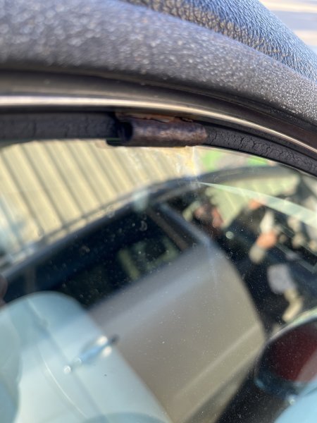

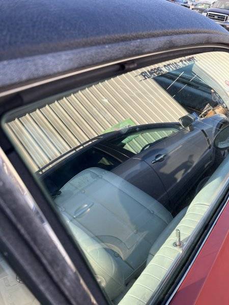

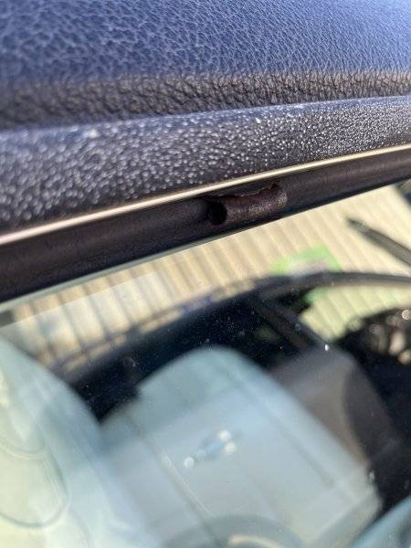

I am currently working through my 1973 Charger and I am currently getting the doors and windows adjusted and properly working. My passenger door window seems like the backside(by the handle/lock) is a little low.
How is this adjustment made and secondly, what are these metal protrusions? Can they be replaced and if so, where can I source them?
Do they aid in anyway the sealing properties of the glass?
Thanks in advance,
Kurt
You have some good tips here, having gone through this on my car. I’d just add, if the adjustments may require loosening the bolts at the bottom of the door, be wary, so as not to strip any. My ride is a CA car having little rust and took the entire car apart with little trouble unlike the first rusty one I restored. But, I stripped a window bracket bolt on the bottom of the door. Don’t know the condition of your car; but if they look rusted, shock the bolts and soak them good with penetrating oil leaving them set for a few hours. Shock the bolts again before trying to loosen them. You may not have to mess with them; but just saying..
