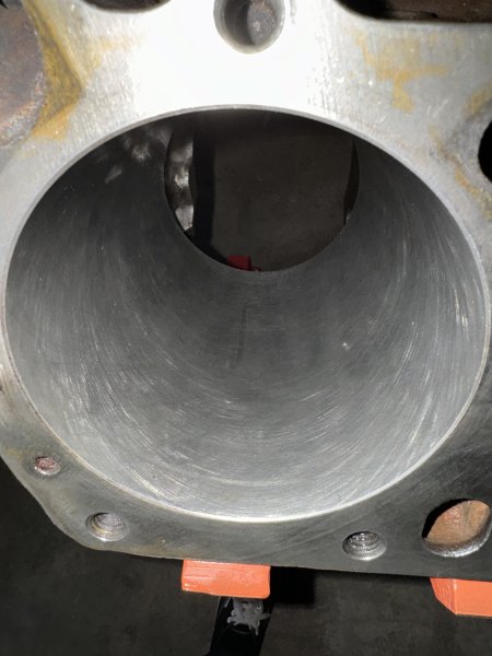

I have considered that. But wouldn’t I need to get the cylinders bored due to having light etchings where my rings stopped at the top of cylinder? I heard going past that with new pistons could break piston rings.
Maybe. It might not have that many miles since the rebuild, and a good hone might be all you need.
I can barely feel the ridge the rings left with my finger except in one of the cylinders it’s rather pronounced. I could probably hone them all out by hand I would think. Talked with lunati cams rep and he said they don’t have a solid cam suitable for me having the lower compression he needs 10:1 minimum or else it won’t run good he said. Also included one of my pistons that’s a little chewed up…should I be concerned using it in rebuild??
Quick way to check bore wear, which is always worst near the top of the bore.
Remove a compression ring from a piston & place it in the bore 3/8-1/2" down from the ridge at the top of the bore; make sure it is square in the bore. Measure & note the ring gap with feeler gauges.
Repeat the procedure with the ring at the bottom of the bore, in the unworn area. Subtract The two readings & divide the result by 3. That is your bore wear.
