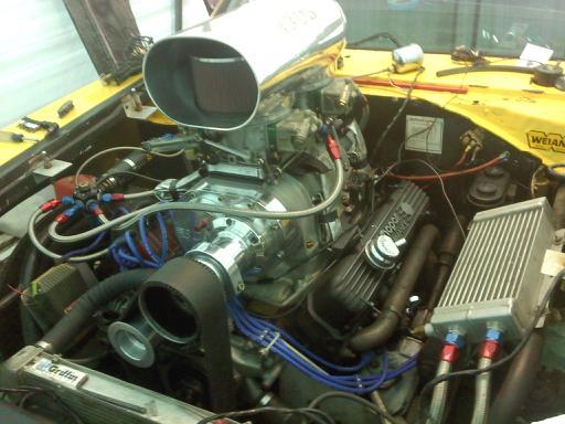

I am getting ready to drop in my racing engine and I need sparkplug wires. How do I go about selecting the best wires? Is there such thing as overkill? Do I need to match the wires to my particular application. I plan on upgrading to an MSD ignition some day but just have the mopar electronic ignition with orange box for now. Any recommendations or experiences would be helpful.
I would say get the wire with the "lowest OHM resistance/per ft." that you can, that have the proper style & fit of ends you need for your application... You can get 7.5mm wire with 40ohm per ft. of resistance to 10.5mm with as little as 40 ohm per ft. of resistance, with a carbon type core, if you don't care about radio interference, get a solid core wire, you need to check the OHM rating, most are way up there, especially on some of the bargin or more advertised brands, some are as high or higher as "2000ohm per ft. of resistance" that's 50 time the amount of a true quality plug wire... If they don't list the OHM resistance, it's no doubt pretty darn high....
