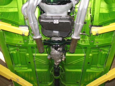

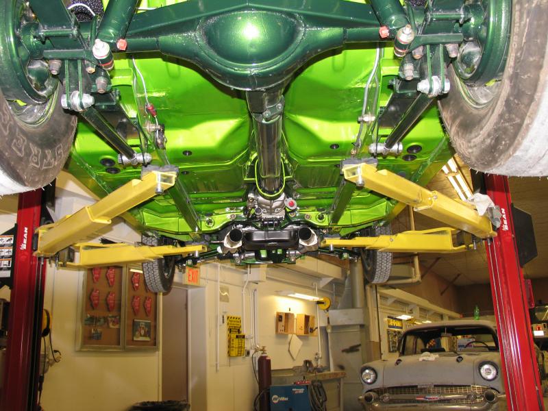

LOL. For a "good" write up on installing a Gear Vendor, see my "80 Grit" thread. I literally JUST (I mean 30 seconds ago) posted the first entry in my Gear Vendor install string... Stick with me and I'll provide al the detail I can. I'm hoping the 727 / Gear Vendor combo is as bulletproof as I'm told it will be.

gear vendors was a last resort for me, they still require some modifications
Very minor though. I had one and liked it in theory. I had some vibration issues that later turned out to be UNrelated to the GV unit.

I also questioned Gear vendors about a deeper overdrive - I'd like to be able to run 130 for an hour - but they just don't do it, so I went with the .78. We should know by this evening how much modification is required. Either way, once the car is running a mini-tubbed four link with a 770HP motor and all the modifications associated with that, I'd say your past worrying about modifications!

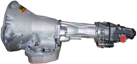

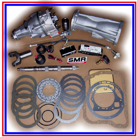

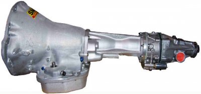

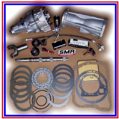

SMR Transmissions shorty Overdrive, gear-venders combo's
different levels Powerhorse 727, Street pro 727, Pro Sportsman727,
Competition Eliminator 727 or MegaTorque 727 or trans-brake 727
GV shortie-option can be added to any of them for like $3050+
or have a qualified tranny guy,
that knows Mopars/727tf's really well, build it for you
http://smrtrans.tripod.com/smrtransmissionsintro/id32.html
It's not an endorsement just something to look at/consider,
not sure if it's proprietary or not, too long ago, but it's some cha-ching $$$$
good luck & happy Moparing
  • SMR 727-TF 78% shortie overdrive Gear Venders 41.5 inches long only 7 inches longer than stock 7.jpg
