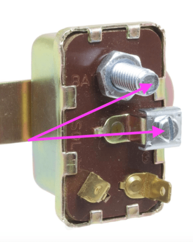

Is the trans in park? First make sure it's in park cause having it start in gear never ends well..... Next try jumping the solenoid...
This is a location picture for a 64 Chrysler...
This is the two posts you touch with a screwdriver to get the starter to crank...
If it cranks that proves the starter is good, the battery is good & the relay is probably good... If it doesn't then we can take another look at the starter & battery... But lets try to narrow things down..
