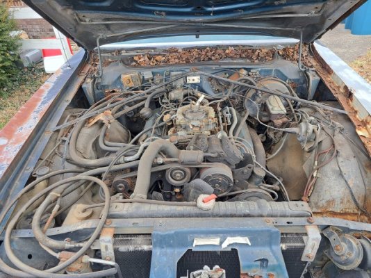

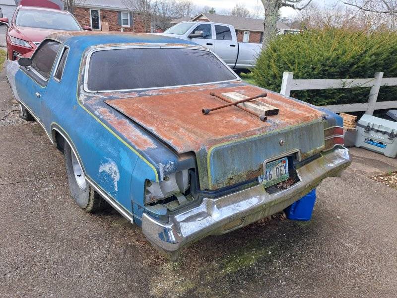

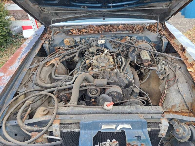

Right now she lot drives. We're needing a turn signal canceling cam, drivers taillight bucket, fuel tank cleaned out.

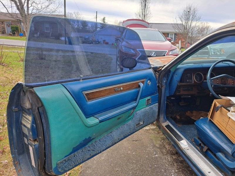

Down the road, we want to convert her to a power bench seat and column shift with cruise/tilt.

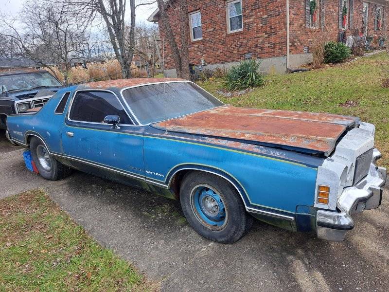

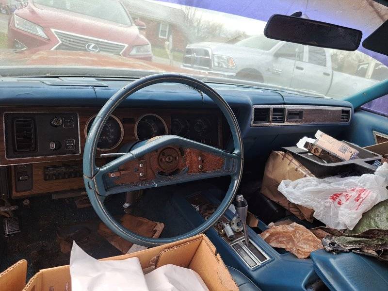

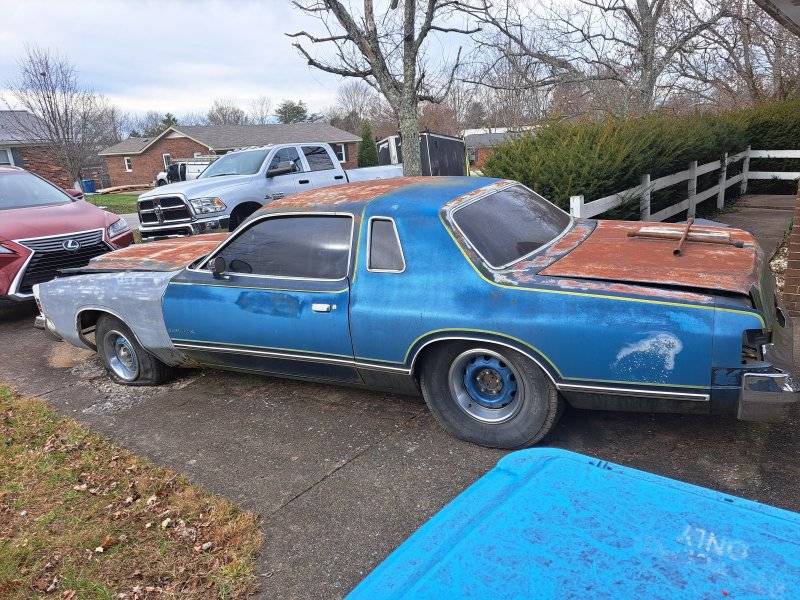

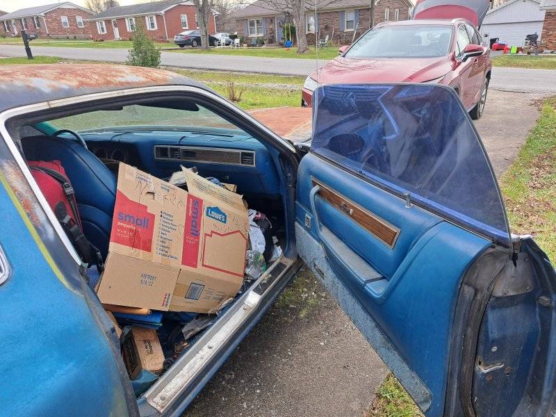

If it's drivable, keep it going. You can do various fixes and upgrades without much downtime.
Lets see some pics. Don't see many 76 Daytonas
Always wanted one. Best late 70s car.
20231216_122020.jpg20231216_121934.jpg20231216_121856.jpg20231216_121836.jpg20231216_121808.jpg20231216_121751.jpg20231216_121731.jpg20231216_121711.jpg
I say clean it up and get it running and driving with what it has and see what it needs. Dont just take it all apart with the intention of a concours resto, and never get it back on the road. It should be a fun car to drive with that 400.

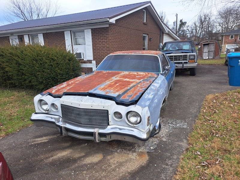

I was told that our Daytona has the wrong grill.

Wth a low compression engine like that 400, the MP cam would not be a wise choice. Sound cool but no poop. Maybe get ahold of Hughes for that. Mopar only and one of our site sponsors.

GREAT CAR! I had a 400-4bbl 77 Cordoba. Check here and www.moparts.com and EBay. The tail light might be hard to find (?). It looks like a Dodge Magnum tail light (?). I’m not sure about your grill.

I don't see cam specs?
A mild to moderate bump should be OK.
400 has a big, oversquare bore and should flow well if given the chance.
The B 400 is an incredibly underrated Mopar engine.
Great start to a cool driver, 400's deliver just fine with free flowing exhaust and a properly functioning Thermoquad. Don't see many of these , they are an under rated touring car that is really enjoyable to drive.

Is it going to just be easier to find a bench/column Cordoba instead of changing this Charger over?
