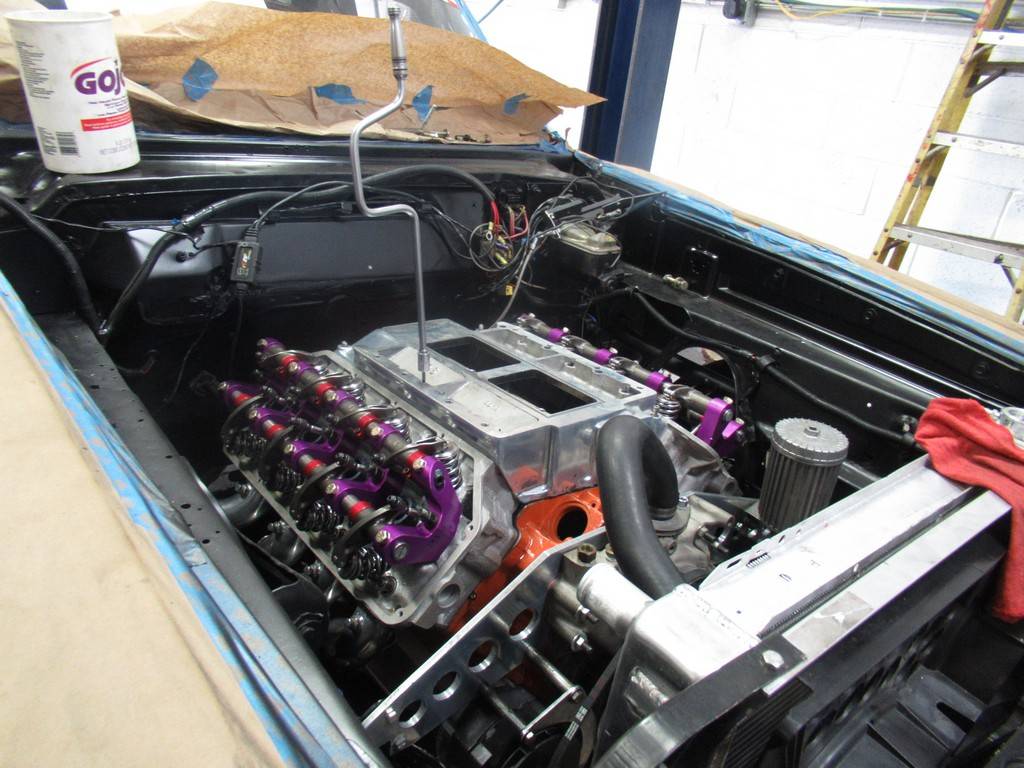

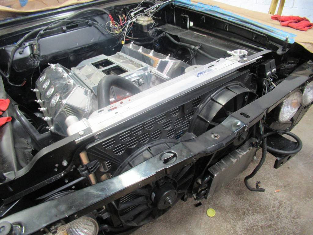

Took out a 26 inch inch stock tank with high efficiency core and bought an Afco 1 inch tube 3 pass for $200.Drove the car in the heat,160 stat and it was 180*
545ci blown hemi

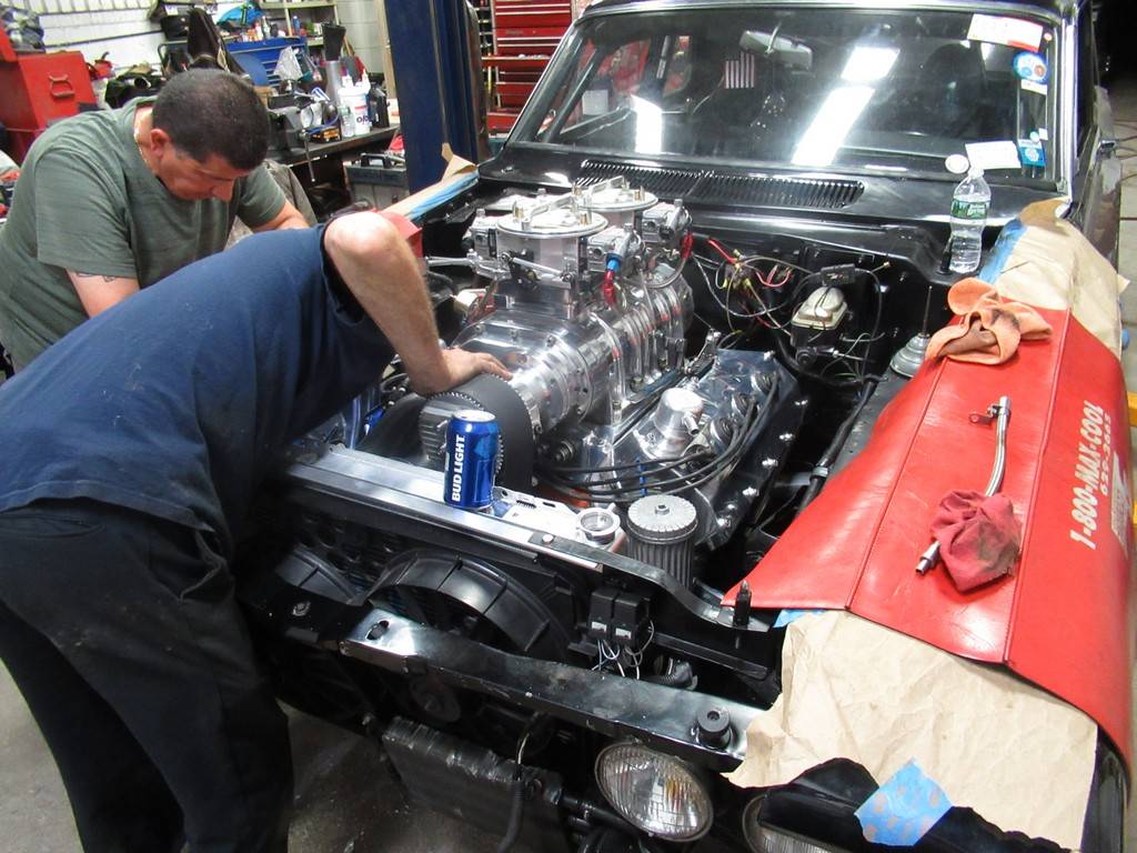

BTW,I only changed to save weight.Also installed an aluminum driveshaft:thumbsup:

Thanks Chris,I would be interested in a better,skinnier,lighter double fan.I have a pair of pushers due to lack of spce between the lower blower pulley and the radiator.
