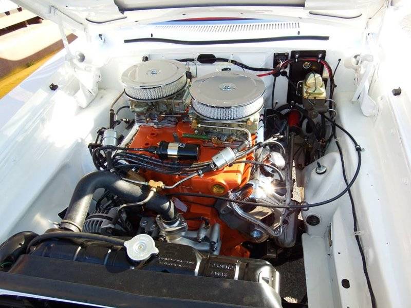

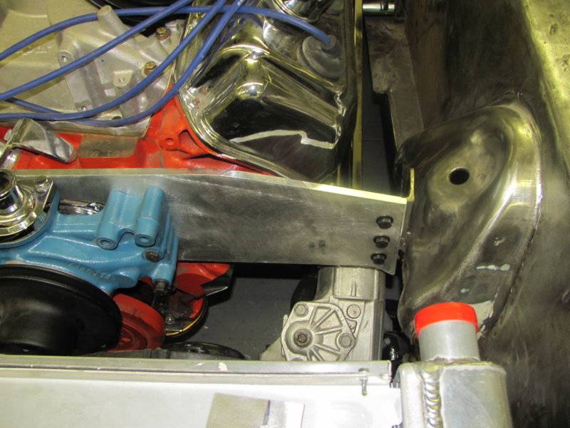

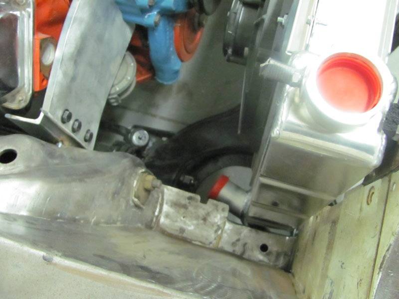

I had a hard time with my 63 Sport Fury. So I changed water pump outlet to driver side with corresponding rad. and had no other problems. For some reason pass side outlet is way lower than the rad. inlet. I could not find the right hose. it kept sucking closed, just my Experience. Not sure if will help ya ! tried a few diff. ideas as you can See.
View attachment 754168 View attachment 754169
I have a radiator with the lower outlet on the driver side but it was about an Inch from the steering box and down low , no way it would work , that is what made me get the radiator . But thanks John

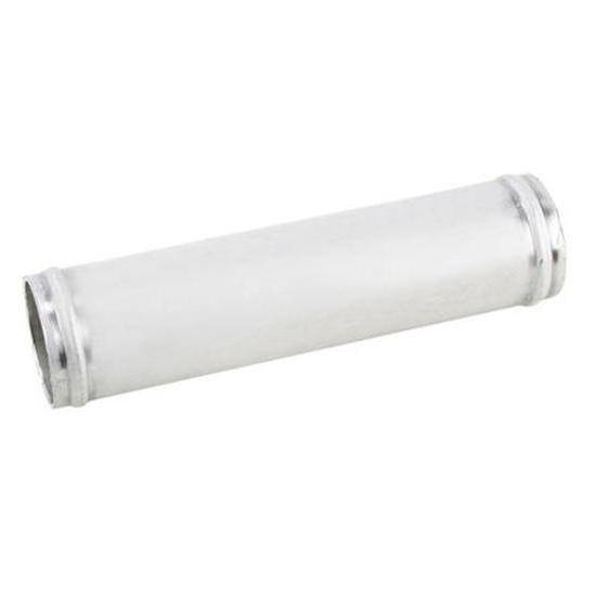

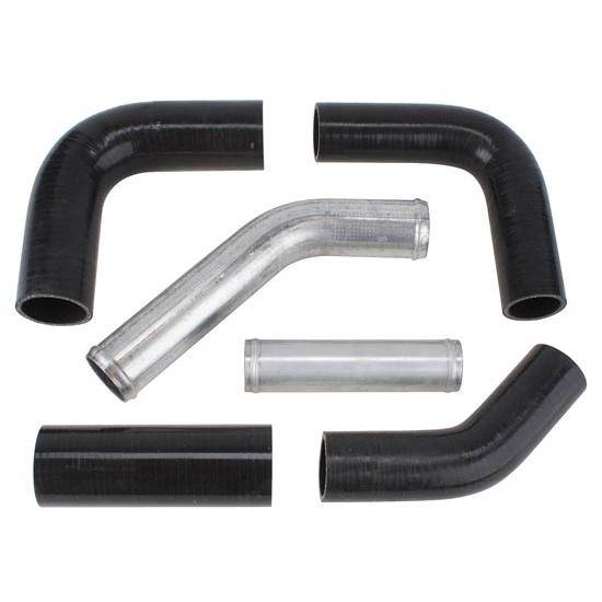

Many thanks for all your suggestions . I remembered that Speedway Motors has hose kits , aluminum hose spacers for 1 1/2 and 1 3/4 so you can made your own stuff for different combos . I may have to go this way due to the size of the radiator and motor placement . The radiator that had the lower hose on the drivers side ran right into the steering box . Again Many Thanks John
