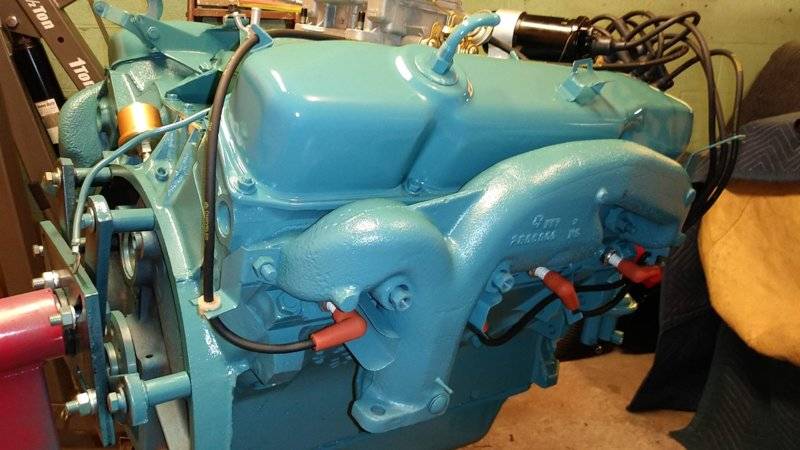

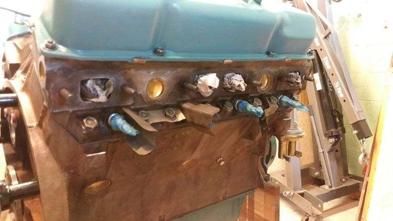

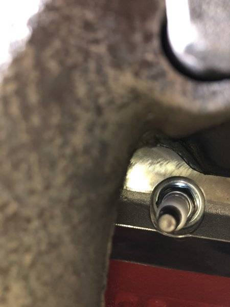

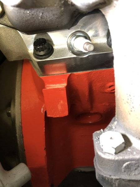

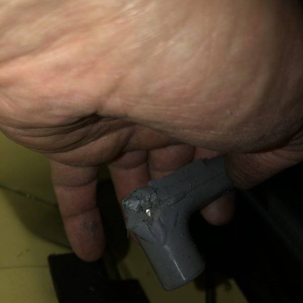

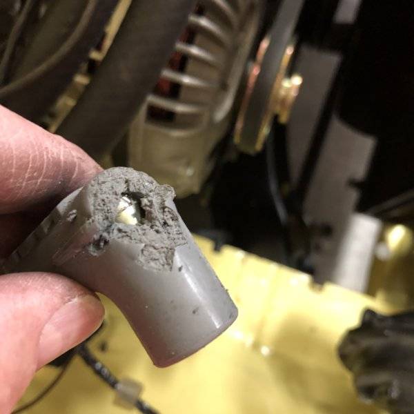

So, edelbrock says the 5090 heads will work with stock manifolds. Not to sure about that. Stock 69 hp manifolds. Passenger side 6 and 8 is the issue.
Went to run in the motor, 383 based, and it worked flawlessly for about the first 19 minutes, then started a periodic miss, which got worse. Shut er down. Next day went to diagnose things and the the #6 and #8 msd 90 degree spark plugs boots were near disintegrated from the heat of the manifold. Need to know if any others have had this issue and what you’ve done to combat the problem, straight boots that can be bent slightly? a different brand? I don’t know and only want to do this one more time. Any help is appreciated!!!
Issue is the angle plug on the heads point the plug too close to the manifold, I think anyway.
Please help
Are you able to install the one piece heat shields for #6 & #8 plugs that mount to the head bolts?

From the looks of it, no. The edelbrock heads are angle plug, which would prohibit this. Thanks though!
I’m wondering if the msd straight boot that are bendable by 15 or 20 degrees might be best. Anyone?
I agree ceramic boots.... Back in the day Rajah clips were the best option but ceramic boots are better.

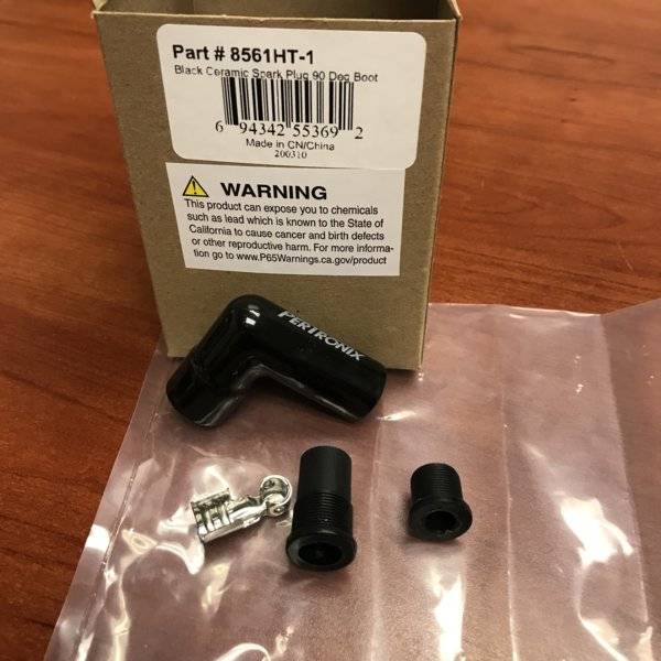

garage today they showed up , those very same Pertronix 90 Degree Black Ceramic Boots a pair
I have not installed them yet , but was reading about them last week when I purchased new spark plug wires from Pertronix

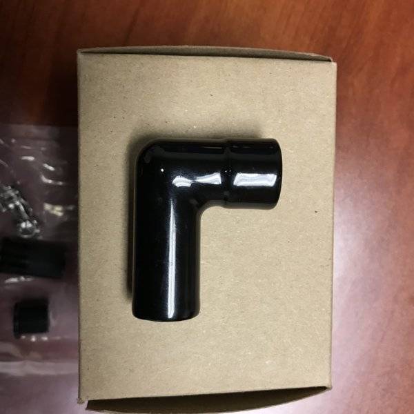

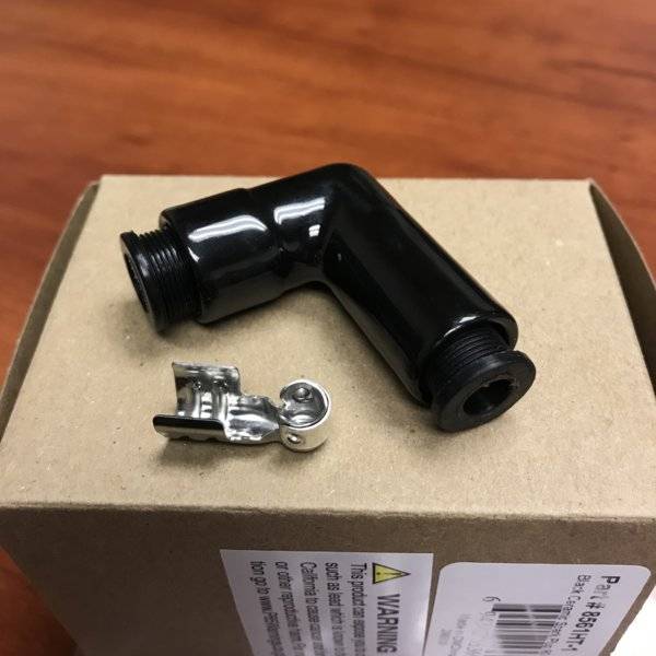

How thick are the 90 degree pertronix boots IE: how close will they get to the manifold? Could you try on on and take a pic? Would be much appreciated!
I can take pictures of the ceramic boots tomorrow boss
There still in a box LOL
I will measure thickness
Anyways won’t get back under the car until next week
It’s supposed to snow tomorrow
Unreal
Working straight thru the weekend
Scott
2” Long
About 3/4” wide on the wide end
5/8” on everything else , 90 degree bend next to exhaust
I see no reason why these wouldn’t work perfect other then the rubber adapters are designed for 8mm wires
My Pertronix wires are 7mm
So with that said plenty of options
My DEI Titanium Boot Protectors are working fine also
