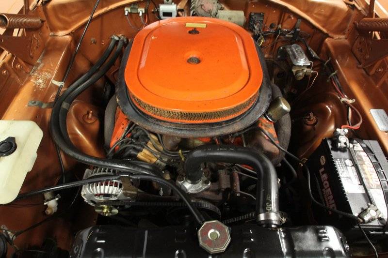

When the engine bay was painted the tops of the shocks, brake lines and brake back up plate were painted in the process. So it means a cheap repaint which brings in question the quality of the outside paint, so you would have to see what the outside finish looks like in person. The fender tag is really rusted, yet fender is nice...so I wonder how much filler is in the body. The interior is rough. The crack in the console is expensive to fix well, dash looks to need a rebuild. Tan parts are not easy to find and not cheap. Probably the easiest fix is the poor carpet.
To me, the car is priced high for the condition...not a lot of room to fix things without being upside down pretty quickly. If it ran well, and didn’t need a repaint, you are probably $10K in parts to fix the stuff we visually see in the pics.
