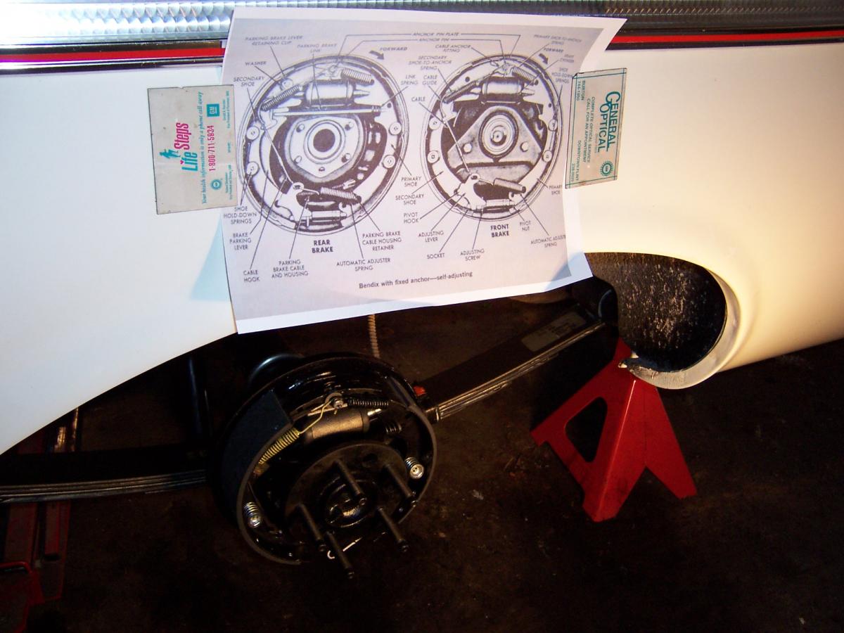

Here's part of it, looking for the rest :)

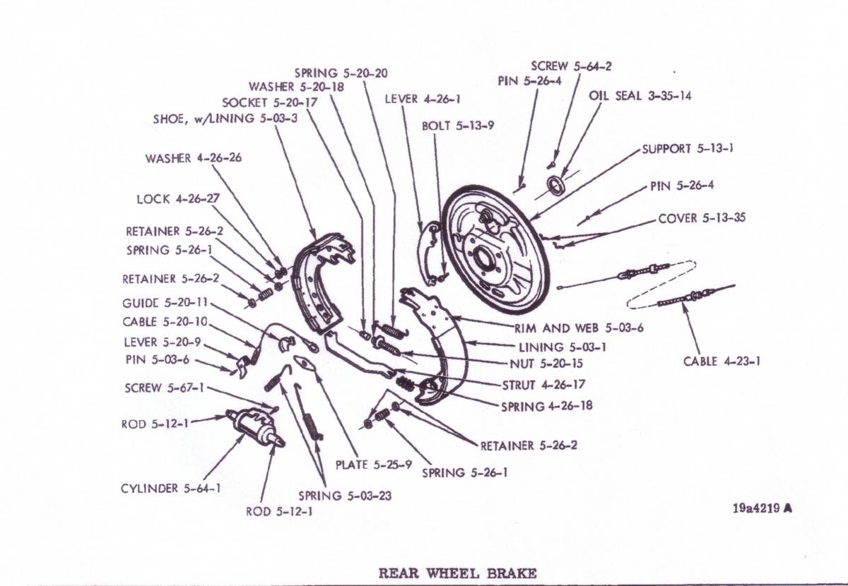

Here is a '73 E Body. Cannot put my hands on a '65 TSMA :shruggy: Just compare with what you have, should be real close. I'll keep looking.

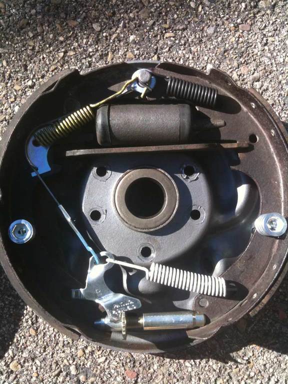

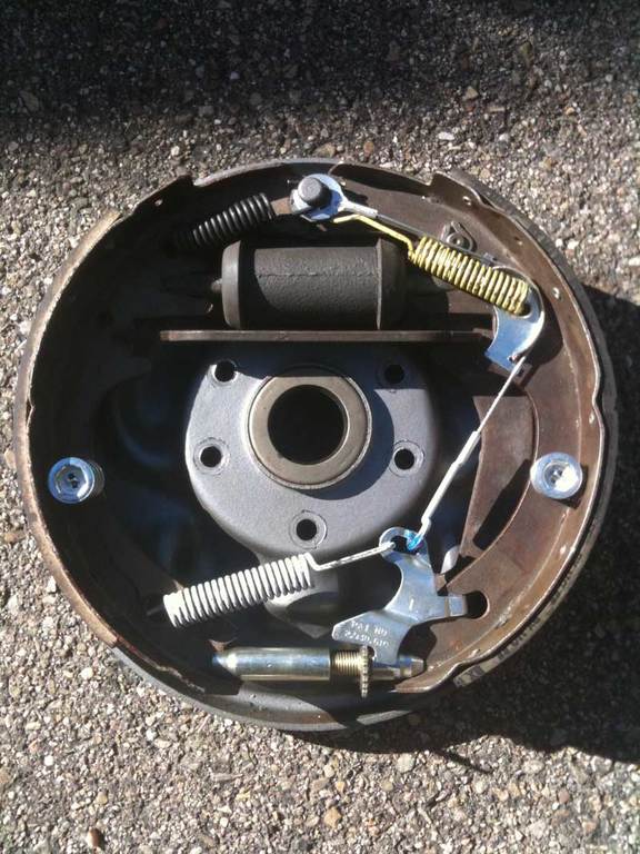

Here are my 64's rear brakes if it helps:
Passenger side
Driver's side
HitIt, looks like your missing the "square" spring that goes on the flat bar. Item#4-26-18 in the diagram. Keeps the bar from rattling and maybe falling out :)
My 66 has the small square spring on the emergency brake link

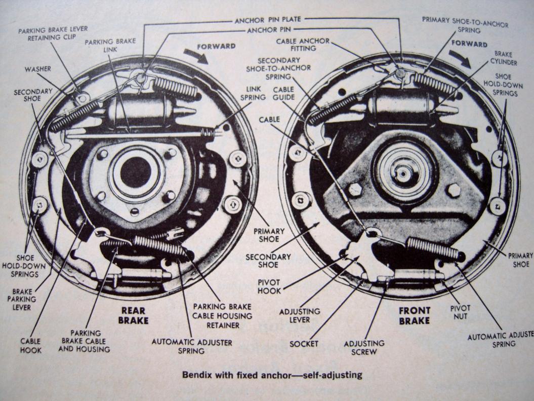

From "Chilton's auto repair '64-'71" and listed as Bendix '64-'66
You guys freakin' ROCK! THANK YOU THANK YOU THANK YOU!!!:yes::yes::yes:
