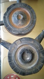

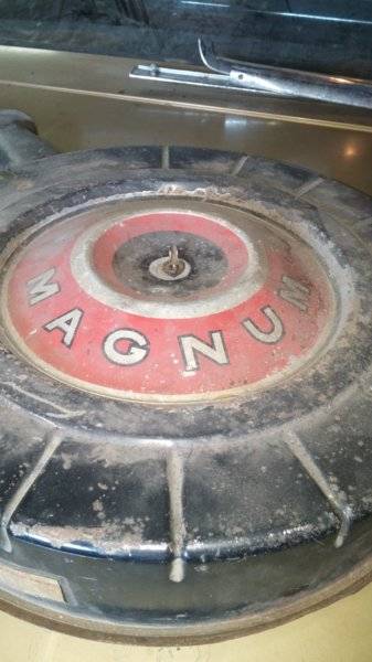

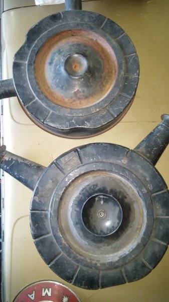

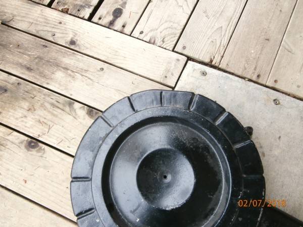

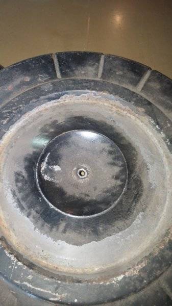

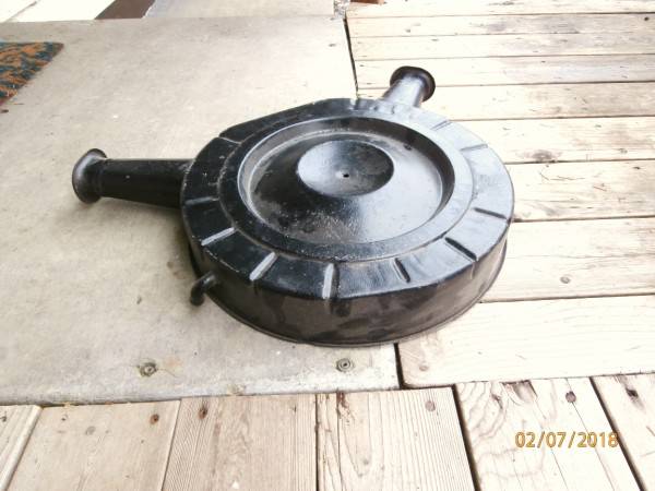

Here are pics of the upper lid that I have here. The snorkels are the same length as yours, 6-1/2" long. Has a large flat indentation in front, between the 2 snorkels. Has very small indentation in the rear, much smaller than what is shown on yours. Mine also has the CAP hose nipple on the outside of the lid.
I had a lid just like this a few years ago....we had determined that it was indeed a 68-69 B-body 383-440 top lid.....I had it up for sale in a number of forums and on Craigslist. Finally I had a guy drive 70 miles to buy the one I had listed on CL.....he was thrilled to finally find one....he said that it was very hard to find....and he looked it over carefully, he knew what it really was
So now I think I have another one here, but I need an OE 67 R/T lid.....if indeed I have another 68-9 lid, the owner wants to made a "trade/cash" deal for what he needs and use this lid as trading stock
Bryan
P2070001 (600 x 450).jpg P2070002 (600 x 450).jpg P2070003 (600 x 450).jpg P2070004 (600 x 450).jpg
I see now... I would say that the lid is 440 RB based on the diameter of the wing nut indent. The CAP tube in 67 was on the DS snorkel.
Maybe that's for a 69 C body? Looks like they moved the nipple from the snorkel to the side in 69.
C bodies had torsion bar hood springs, so that would explain the "flat" area on the back. Just not sure if C and B bodies used the same air cleaner.

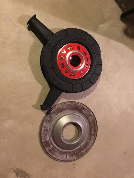

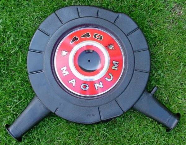

I concur. Original for my '67 Coronet R/T 440 has 13 ribs, flat spot area at front and rear and 6 1/2 snorkels.
Your lid, or cover, appears to be for a 383. A few years back I purchased what looked like a 440 air cleaner. It wasn't until I compared it to my 440 unit that I saw the differences. My 1st clue was the 440 pie plate did'nt mate up properly
