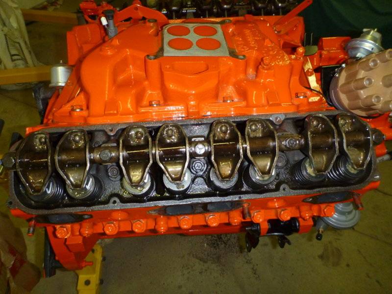

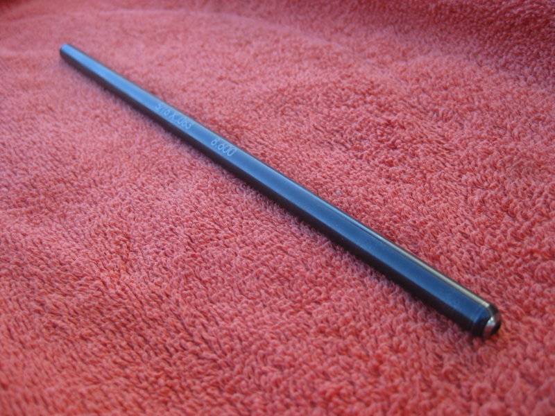

I basically want to know if the push rods I'm using are causing my problem.
The 383 (original engine) in my '64 Polara has a sputter that I can't seem to tune out. I've tried multiple carburetors, distributors, ignition boxes, timing settings etc. and still sputter persists. It shows itself on mild acceleration and cruising speeds.
The reason I am looking at push rods at this point is this. When I was building my engine nine years ago, my buddy said he had a brand new set of push rods for a 383, so I used them. They didn't come with a part number and they felt right when I torqued the rocker shafts on, so I went with it.

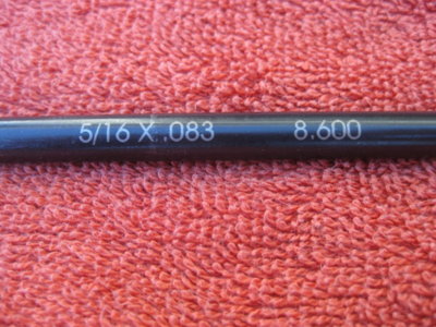

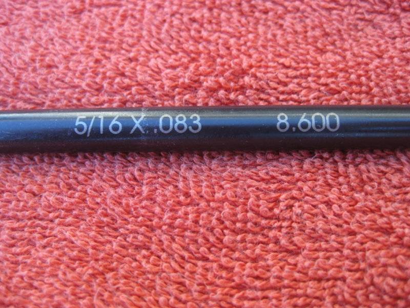

I recently did some research and found a stock length rod should be 8.645" long. I pulled a rod today and it is labeled 8.600", so I'm looking at a .045 difference. Is that a problem with hydraulic lifters? I also just learned stock should be a non-oiling rod, and the rods in the car are oiling. Is this a problem?
Sealed Power replacements are 8.645, and Melling replacements are 6.635. Could .035-.045 make enough of a difference to make this car sputter?
Here are the engine details:
Original '64 383 bored .030 over
Keith Black Hypereutectic pistons
Lunati 60300 very mild cam
Lunati 71977 recommended lifters
Edelbrock E-street Heads
Rockers are stamped Comp Cams
I would say your problem lies elsewhere. Although I agree there is a chance that a longer pushrod would be used if they were measured and custom made. However, being a hydraulic, you are still very much in the ballpark, especially if the motor was blueprinted, and likely decked as well as the heads.

I realize it's a bit late, but it's my understanding that whenever a new cam and lifters are used, the lifter preload should be verified for .020"-.040", possibly different specs per cam manufacturer. I know that when I installed a stock grind Comp cam and lifter set, along with a new stock rocker/shaft assembly it produced way too much preload and had to order specific length shorter rods to get close to the .030" I was after. Everything worked out great once that was established.
I could see too long causing an issue with hanging valves off the seat when the lifter is pumped up, but being short would only likely clatter, but run fine otherwise.
Really? Pardon my ignorance, but I thought all hydraulic lifter push rods where oiling, meaning oil passes through the push rod to lube the rocker arm pocket. How else would it get lubricated? Can someone elaborate?

What style lifter does it have? Lifter design changed sometime in the mid 60's. The push rod shown would be for the later style lifter.
What type push rod is it? (can't see on the pictures)
If this is a ball/ball type then an oiling hole is required according me to lubricate the upper end, well...when using aftermarket (roller)rockers with cup type adjusters you do.
Does the Comp Cams stamped rockers have an oiling hole as well?
When the push rod is installed, with the lifter at camshaft base circle, is there any preload visible?
Is the little inner piston off the circlip/retainer? Probably is otherwise you would have a noisy valve train you would have noticed.
