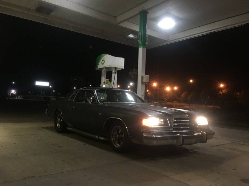

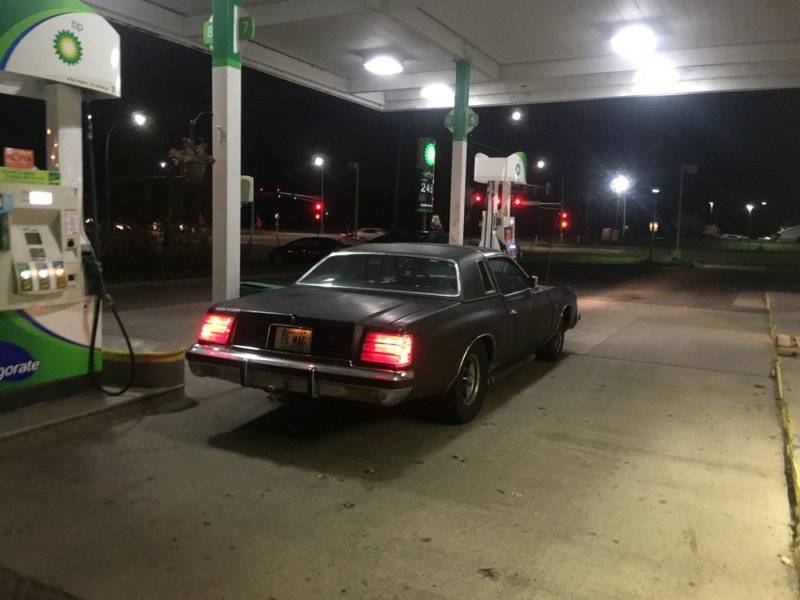

Bought this hot rodded 78' Magnum XE a while back as my first car in my name. It always blew a little white smoke, which was expected for a 40 year old car, but the oil level never seemed to change. Then one day it had a really hard time starting and was misfiring like no other. Checking oil again and it's totally maxed out, obviously contaminated with coolant. I suspect the oil level never changed because coolant was leaking in as fast as it was burning it up, but I don't know for sure. I have a couple options. I have a complete 2002 Ram Van 3500 with a 360 Magnum, paid $200 for the whole van. Runs, 110k miles, no codes, lots of power, no knocks but it vibrates even in neutral. Likely due to it being incorrectly balanced or a bad motor mount considering the condition of the body.
