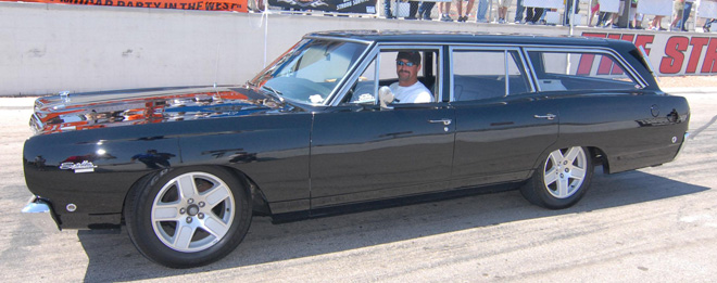

Damn that's nice but looks about 30 feet long in that photo!
