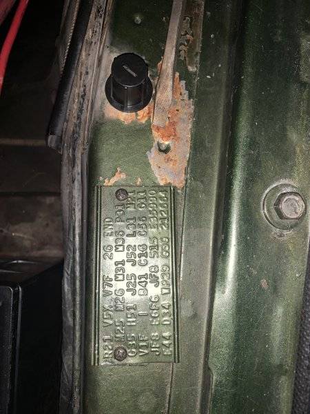

WP29:
Dodge Coronet,Charger
Premium
2 Door Sports Hardtop
G3G: 318 150HP(net) or 170HP(net) 1-2BBL 8 CYL
1973
St. Louis, MO, USA
212664: Sequence number
E44: 318 cid 2 barrel V8 230hp
D34: Light Duty Automatic Transmission
JF8: Dark Green Metallic (Dodge) Exterior Color
E6F6: Vinyl Bucket Seats, Green
JF8: Dark Green Metallic (Dodge) Int. Door Frames
515: Build Date: May 15
E35990: Order number
V1F: Full Vinyl Top, Green
I: International (export) Specifications
B41: Front Disc Brakes w/Standard 10in RR Drum
C16: Console w/Woodgrain Panel
C56: Bucket Seats
G11: Tinted Glass (all)
G35: Delete Standard Outside Mirror
H51: Air Conditioning with Heater
J25: 3 Speed Wipers
J52: Inside Hood Release
L31: Hood/Fender Mounted Turn Signals
M21: Roof drip rail moldings
M25: Wide sill moldings
M26: Wheel Lip Moldings
M31: Belt Moldings
M36: Rear Bumper Periphery
P31: Power Windows
R21: AM/FM Radio (5 1/2 Watts)
V5X: Body Side Stripes, Black
V7F: Accent Stripes, Green
26: 26in Radiator
END: End of Sales Codes
Odd to have AC and PW on an SE, but not PS.
Mighty odd.
Interesting "mirror delete" as well.

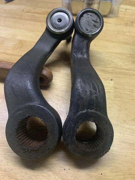

Sometimes the evidence presents itself. What's in it now? If the column is in it, and looks like it was never removed.
I bought new NOS front end parts for the car and while removing parts I noticed my new pitman arm is different shape and larger diameter. The output shaft steering box in my car is 1.0? The arms are completely different.
It looks like maybe someone put the wrong steering box with pitman arm in. My new pitman arm is k7076 which is I believe 1-1/4". I would like to put this car back together correctly. I'm not sure about the column?
Mighty odd.

WP29:
Premium
1973
St. Louis, MO, USA
C56: Bucket Seats
J25: 3 Speed Wipers
M31: Belt Moldings
P31: Power Windows
26: 26in Radiator
