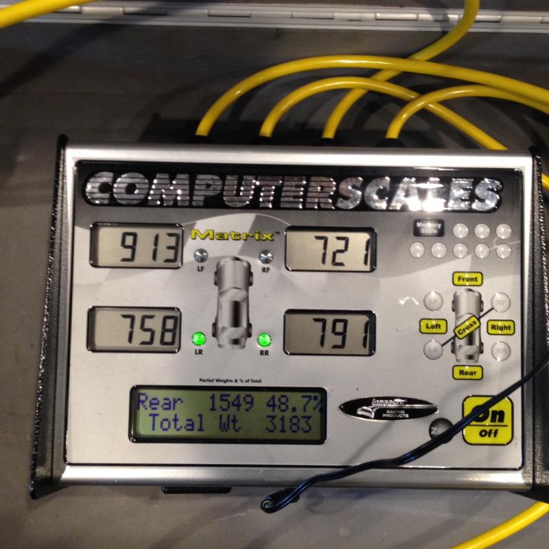

Canyon do you know your weight Bias? Percentage balance front to back?
thats with me in the car
Wow 48.7% to the rear that's almost dead even front to rear. I'm gonna assume aluminum block as well as a fair bit of other lightening up front? Heavier *** end too... Dana?
yes all fiberglass through the doors lexan side windows, al heads, al radiator, no interior just got a new driveshaft 18 lbs lighter yet to get it in. yes dana 60 and all strange engineering disk brakes. Before we did all this the car always wanted to go right so that's solved.
