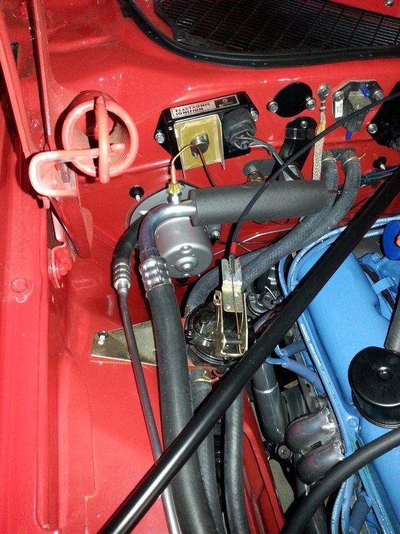

Where is the heat control valve? I have a 73 Roadrunner with a 318 and A/C. Is it in the evaporator under the dash or is it a stand alone valve on the fender well. Best I can tell it should be in the evaporator. If so where is the control cable. I seem to have lost mine under the dash. Any pics would help.

What I am looking for is the cable that attaches to the hot/cold arm on the A/C- heat control in the dash. In non A/C cars it attaches to a cable that goes to a control valve that mounts on the pass. inner fender and controls the amount of hot water that goes thru the heater core. On my A/C car the heater hoses attach straight to the evaporator box. I would think there is a control valve inside the evaporator that controls the amount of hot water that goes to the heater core inside the evaporator or does it just go to a blend door. If so I still can not find the cable under the dash. Does it come from the left or right of the arm? Do I have the wrong A/C-heat control? The arm is made for a cable.
Sounds like you are missing the valve, here is a picture of it on my 73RR with AC.
Ok thanks Idrive. So A/C cars do have an external valve. That explains alot.
