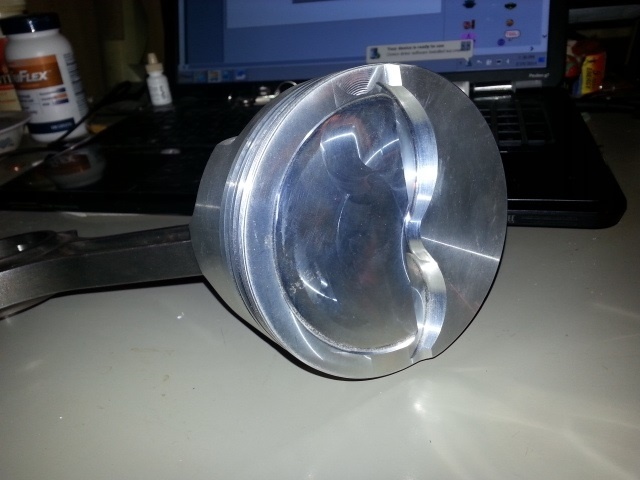

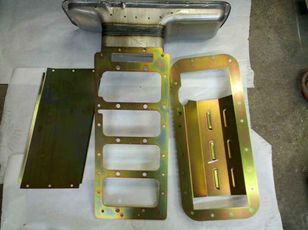

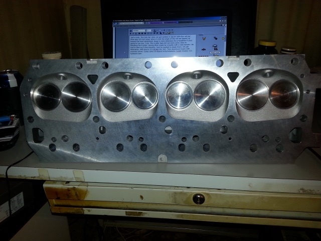

I went with a 543 and I may have to run an
external oil system. 505 - 512 is Best.
