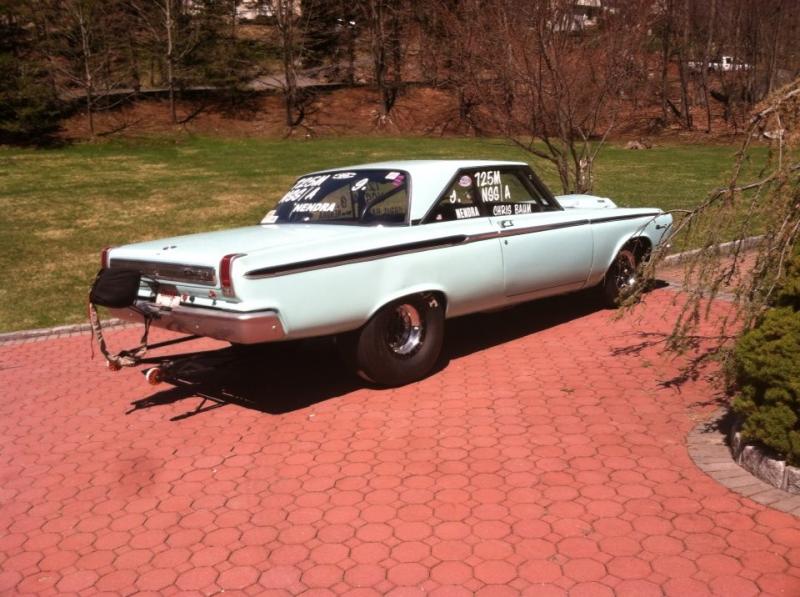

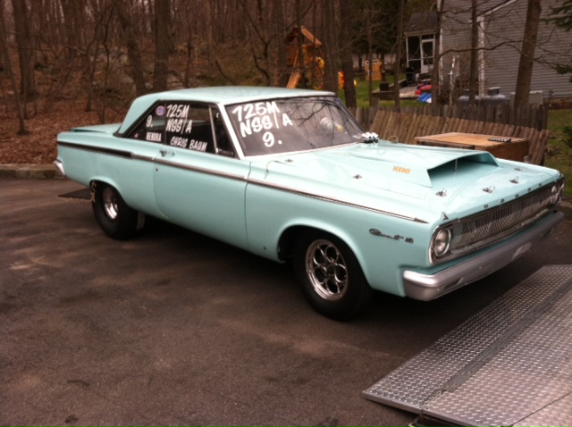

It was way more than a 1/8th of an inch,once the car ws sitting down on all 4's. It took quite a bit of stretching to get it to fit and now I got about 1/4" on the outside.
I tried the rolling trick and that worked for the very low part of the wheelwell but it really needed a lot higher up in the wheelwell.
Here's the finished product. All 4 wheels and tires replaced. Maintenance is key to avoid costly accidents.

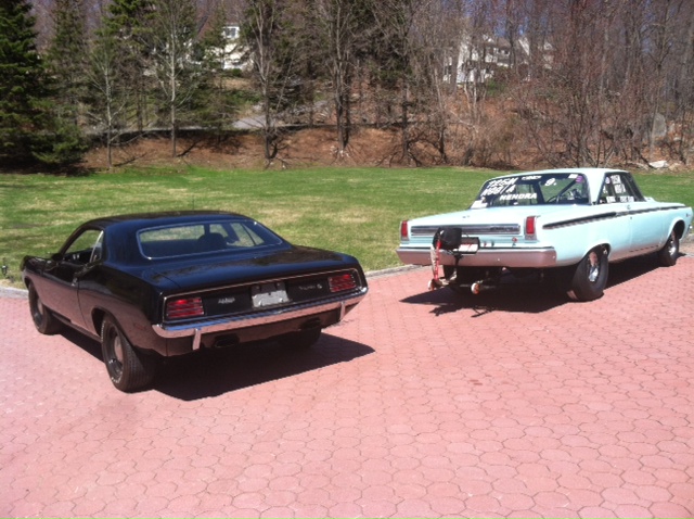

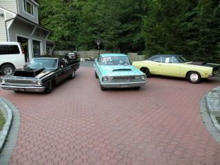

That's a lot of horses in one stable, lol. I have one complete and one project and it's too much for me sometimes!

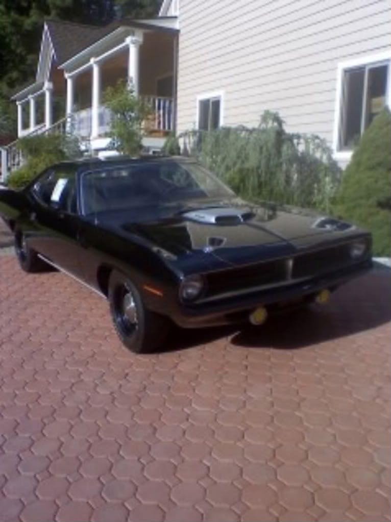

This black on black OE certified 70 Hemi Cuda still gives me wood after all these years.
I like your collection. I am on my second build an a body barracuda for the other half.
I really like that Cuda!!!!
