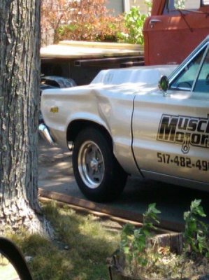

Posting for a friend he is in need of a 1967 Belvedere Drivers fender. His neighbor hit his car and smashed it in beyond reapair. The closer to WI. the better.

if that fender is all good steel and no putty in it, it can be salvaged and maybe cheaper than another one. from what i can see from that pic. it will have to come off though for final finishing.
Agree, very fixable. The days of a simple replacement for any any dent repair are over.
I have to agree with the others. It will be hard to find a nice rust free fender now days. If you can find one it will likely have "Free Rust" included.
like most have said if that fender is a goog solid fender that hasn`t been mudded up it can be repaired it just takes a good metal man to repair it ,and it can be repaired ,dont have someone drill all those holes in it and then mud it up, it just takes time I hate it when we would get a customers car in to redo and it was mud so deep and from top to bottom ,front to rear and there was no need for it, goog luck
I agree a good bodyman ( old school ) should be able to fix it, and I would guess that the neighbors insurance or them would pay for it. If he feels that he wants a new fender then look out west craigslist and others to find one. Where I live there are a few classic junkyards that have these items, but they are not cheap.
