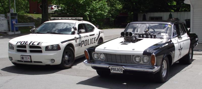

Thank You Everyone. The button was broken. I had to improvise a fix. Hopefully it'll last a long time and until I find a replacement. Here is the car I needed the fix for. DSCF2084 - cropped - Copy.jpg
Now that is cool!!:headbang:
I know nothing about the n button but I have seen your car on here for a while and think it is cooler than S#*t.
That is one hot pursuit vehicle. Glad you were able to fix the button.
