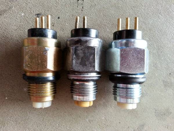

Not all neutral safety switches are created equally, especially those made overseas!!!! I had similar problem that you describe when I put a new switch in. As you can see in the photo, original is in the middle, the one that didn't work on the left and the new one that did work on the right. Turns out the one that didn't work the center pin and plastic section and threads were just a bit too long and caused the issue. Check yours along side the original and you may see the same thing.

I'd do as idrivemopar suggested and compare it with the original but my guess is your either missing the gasket or it's a junk part as mentioned.
Left a fat washer off? C’mon, nobody would do that intentionally. Chinese junk is my explanation.
Its junk import part! Has to be. The gasket is on but not touching because the housing of the switch itself is not made up tight. Sure its working properly but it aint right and it has to be right or I'm not happy. The old one had a pin break off and i chucked it. So now looking for a NOS switch.......The car drama never ends!
Steve, just an fyi, the one I got that worked was from Autozone, the one that didn't work was from Napa.
