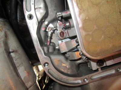

Got my neutral safety switch out and measured it. It is dead..
I have the single wire neutral safety switch. My trans is from ‘69, shouldn’t it be the 2- or 3-pin switch to be correct?

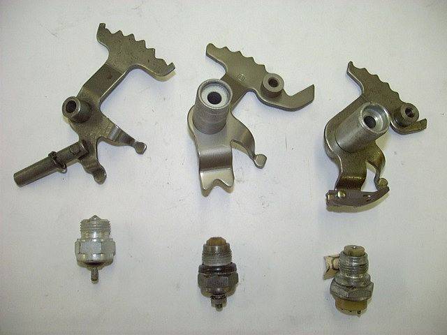

Thanks for this picture! I have a PB trans updated & modified.Right now I have the switch on the left but it does not touch the rooster.The middle one looks like it goes further in and must be the one I need.Can anyone provide me with the part number for that??
Correct, the one on the left is for pushbutton shifted, the one in the center is for console/column shifted up to early '68.
Part number is 2495537
