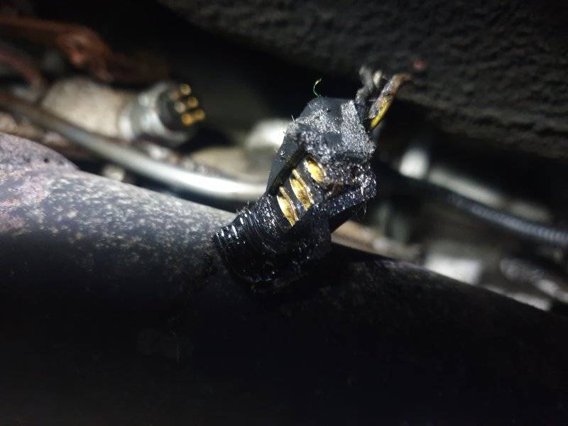

I just had an issue with no crank when trying to start my 1972, 318ci Satellite. It has an MSD 6AL digital ignition system. I cleaned up all the connections and grounds but the issue was still there.
I remembered that I had fiddled with the speedo cable at the transmission because the speedo wasn't working. I also knew the 3-pin neutral safety switch was next to the speedo cable, and that the cable and nss wiring harness were tied and routed together up through the engine bay.
On inspection I saw that the nss had wiggled loose while I had been playing with the speedo cable. I cleaned the nss up with contact cleaner and plugged it back in and the starting issue was gone. Although I didn't have to, I bought another wiring harness as the old one looked a bit rough.
