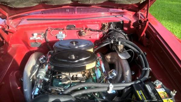

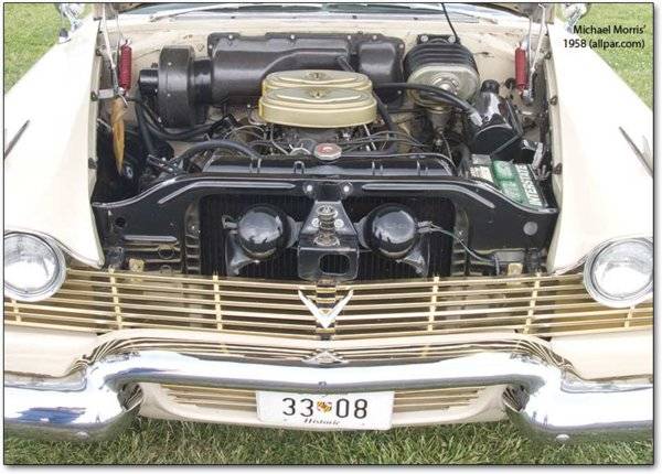

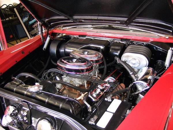

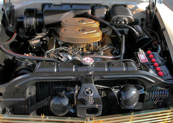

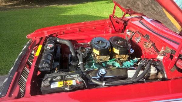

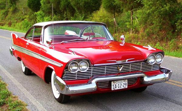

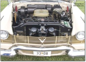

Christine ran one on a 350 B engine. Introduced in 1958 on the Fury, the forward look crowd uses them.

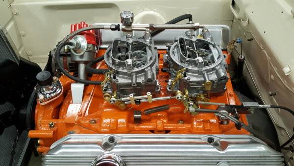

I used the latter on my 440. Carberator linkage had to be modified on the front carb for clearance.
The primaries had to be opened up to accept the 600 Eddies. The ones on right were done in this picture, ones on the left are factory.
