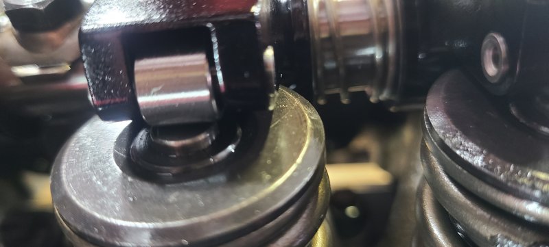

Is it a optical illusion In the picture? Is the roller tip shorter then the sides of the rocker at the valve?
Regardless they need to be centered with the right side clearance. Not runnable as is.

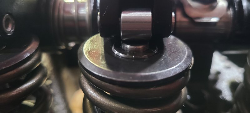

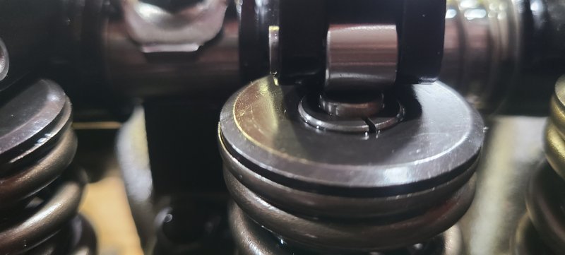

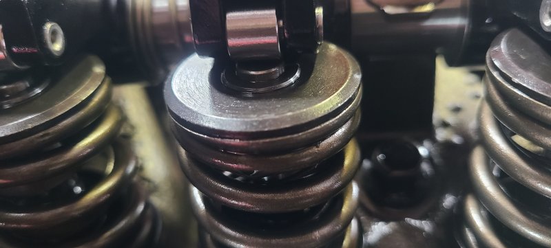

So second guessing myself decided to make sure my rockers are all good. And found this. Not as bad as the 2nd 440 previous, but should I roll or start grinding the bolt tower mounts and shimming?
3rd pic from top. You need to grind a little off the bolt washer to centre the roller on the valve tip. Stamped factory rockers had a very wide contact pad that allowed for variations; not so with roller tip rockers.
Did that. Not enough before hitting bolt tower. Either I go stock stamped or die grind some material off tower. Not sure what I'm gonna do.

I would grind the bolt tower....certainly NOT the rocker. While the stock rockers are plenty strong, their actual ratio is usually less than 1.5.
Actually the builder is going to help out. He's buying back the heads and I'll upgrade to aluminum. That'll solve the problem and get me a bit more CR too. Stay tuned

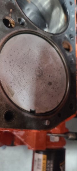

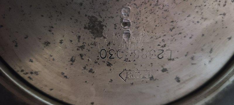

You might be the only one ever to get 170 psi compression test w a 2388 low compression piston!
Only had to advance the cam 43 degrees!
Who'd a guessed?
What an unfortunate piston. For almost zero dollars more, the builder could have put in 2266 or 2355 pistons.
