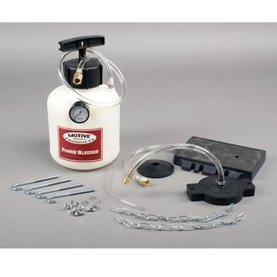

need a power bleeder
well it helps speed up the bleeding procedure anyway
one man job easy peasy
Brakes Motive Product Brake Bleeder Catch Bottles $20.66 pr. mvp-1820_w_ml Summit Racing.jpg
no fuss no mess
