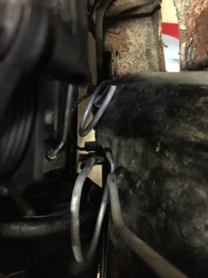

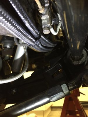

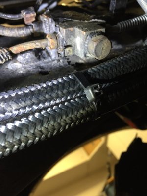

New brake install
Hopefully the disc/drum combo valve will fix the problem. Now the hard part will be getting the old out!
9BB8A47F-ED00-4E15-983C-71C5189F2A36.jpeg F98A6A59-00A9-48D9-B2AA-40E296294DE5.jpeg ED7B23DF-BE74-4661-A6ED-0CAE73ADB1DD.jpeg
Yeah, it’s factory fresh from 1967, I already feel my knuckles getting scraped!
I have installed a few disc brake conversion and never heard of any of this. The proportioning valve should not make any difference when pedal is pressed. Yes it does change pressure front to back, but it shouldn't keep it from working on a hard press. When brake pedal pressed and held is it fading?
No, when pumped it holds just fine. Trust me, I’ve been scratching my head on this since Thursday. Going to try 1 more trick before I tear out the old combo valve.
It could be the linkage between the pedal and the master cylinder or the rod out the front of the booster. it should almost touch the piston of the master cylinder, but not touch.
I’ve adjusted the booster out and I’m back to where it was when I took it out the box. I’ll see if the cab side of booster linkage can be adjusted, it’s the factory style Z linkage, not sure if that can be adjusted.
I was able to get the bottom fitting off and clear fluid came out slowly then I had my son press the pedal and more fluid came out, still clear.[/QUOTE
Your on the right track with removing the old combo valve, but I have to ask were is the new proportionate valve? Shouldn't it be in the line of the rear brake line
Gravity bled all 4 and it takes 20 pumps to not have the pedal sink to the floor. I’ve gone through 2 quarts of brake fluid, and my vacuum pump hasn’t been getting the job done. So I ordered a disc/drum combo valve from Dr. Diff. Pirate Jack is sending another mc, but I already installed one from Oreily’s cause the PJ mc just didn’t seem to get the job done.
