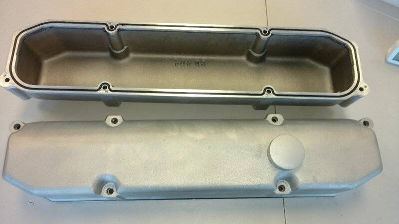

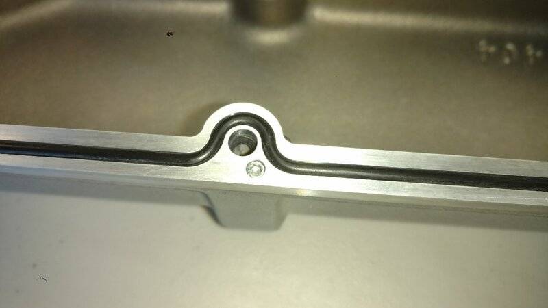

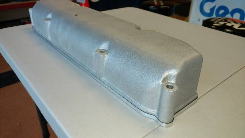

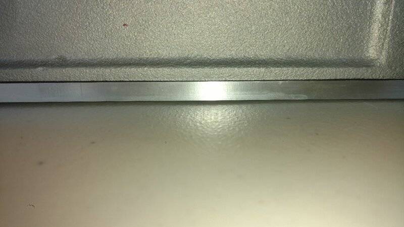

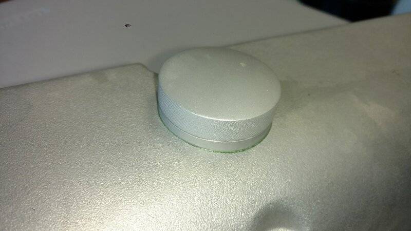

I got my valve covers back from my friend Mark, he really tricked them out. I bought these covers off of Facebook marketplace, I've never seen another set and I liked them because they are different. Originally they had no holes in them other than the bolt holes. He added a trick oil fill cap and 1/4 spacers that seal the covers to the heads with an o-ring, so no gaskets!

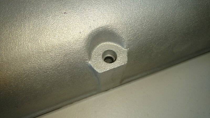

Also, Mark countersunk the bolt holes so the allen head screws will be flush -

I bought these covers from a guy on Facebook a few years ago - I have no idea who made them, I have never seen another set. They have "BD 404" cast into them (see previous pic) I tried an internet search but found no info. I'd love to find out who made them, any help would be appreciated.
Big Daddy? Maybe Garlits made em.
