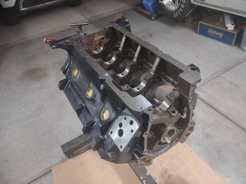

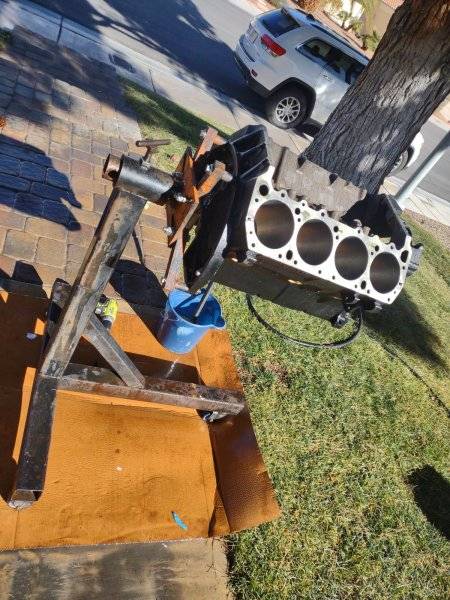

I found some metal in the pan that looked like chrome flakes, after a bunch of investigating I discovered that the #3 cam bearing had failed and was coming apart. Looks like I damaged it somehow when I installed it. SO after tearing the engine down and inspecting everything I've had the block honed and will be assembling the engine again. I got very lucky, no damge to the cam or block - I will be making sure I dont screw it up a secong time.

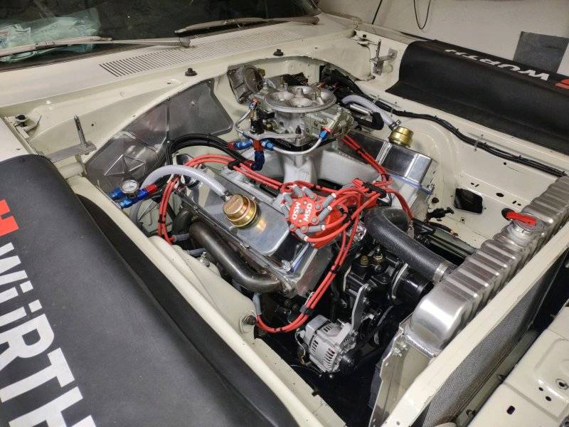

Since my custom PanEvac system was a bust I will be going with different valve covers with the breathers in them. I settled on these Summit valve covers, they were pretty cheap and are polished. They came with holes in them, I used one hole for the oil fill and enlarged the other for the breather grommet then added another hole for the other breather.

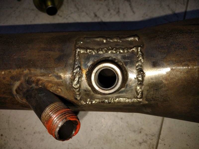

You have to drill and tap the hole in the block for a conpression fitting -

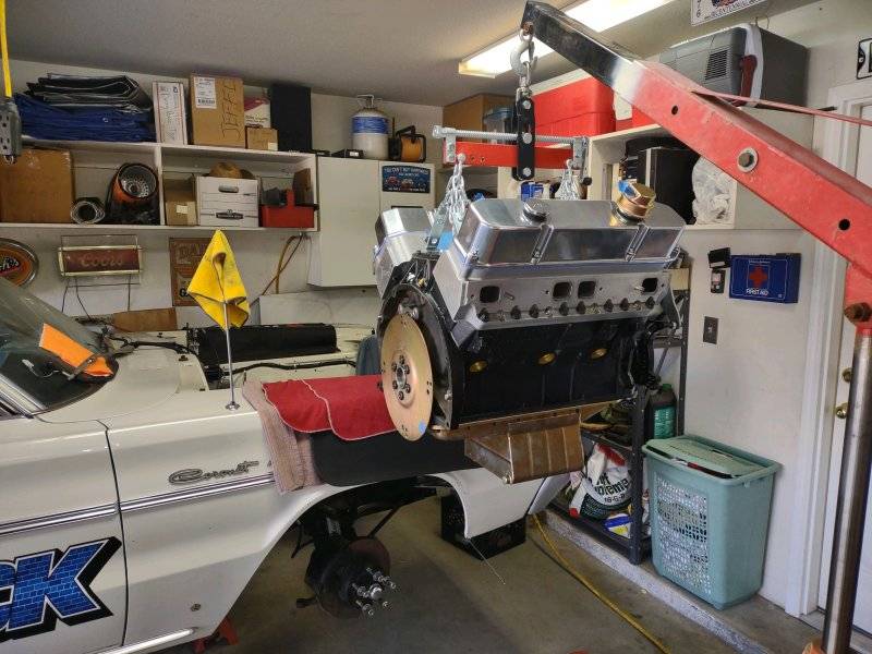

Going back into the car - all of the modifications I made to the mounts and K-member did make installation easier.

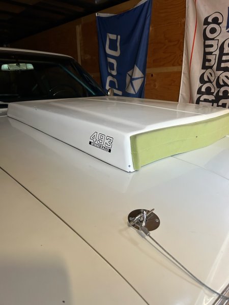

When I fill out my tech card at the track I always write "Winnebago" as the engine MFG, just for fun. I had these made - what do you think? Having the power to Winn is always an advantage!

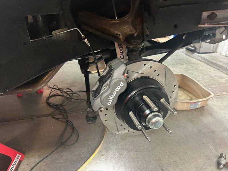

Even with the bigger rotors this set up is 7lbs lighter per side than the old factory stuff -
