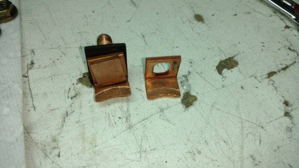

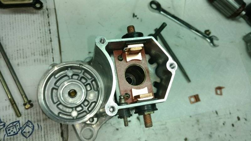

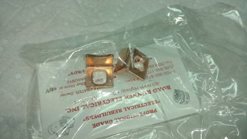

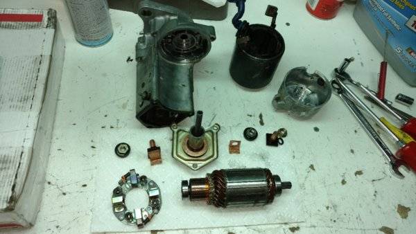

Last night I blew apart the starter to check it out. It's been in the car since 1991 - never had a single issue with it. I still need to split the gear (reduction) box but, the brushes are still good and the armature looks good too - so far the only issue I found is that the contacts are worn pretty good (see close up pic) This is typical for these Nippondenso starters and the contacts are cheap and easy to get.

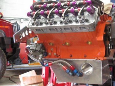

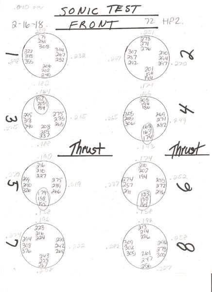

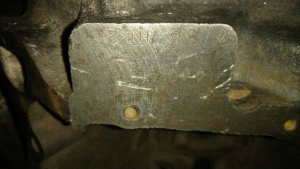

Update - I bought the block from my friend and took it to Bob Mazzolini to get it sonic checked. This one is much thicker than my first block, Here is the worksheet. I originally wanted to go 60 over but have decided to err on the side of caution and go 30 over. It was cast 3/2/72 and is stamped H440, HP2 - so I'm gonna have a legit HP motor! (yea I know it's meaningless) I've spent $725 to this point on the block(s)

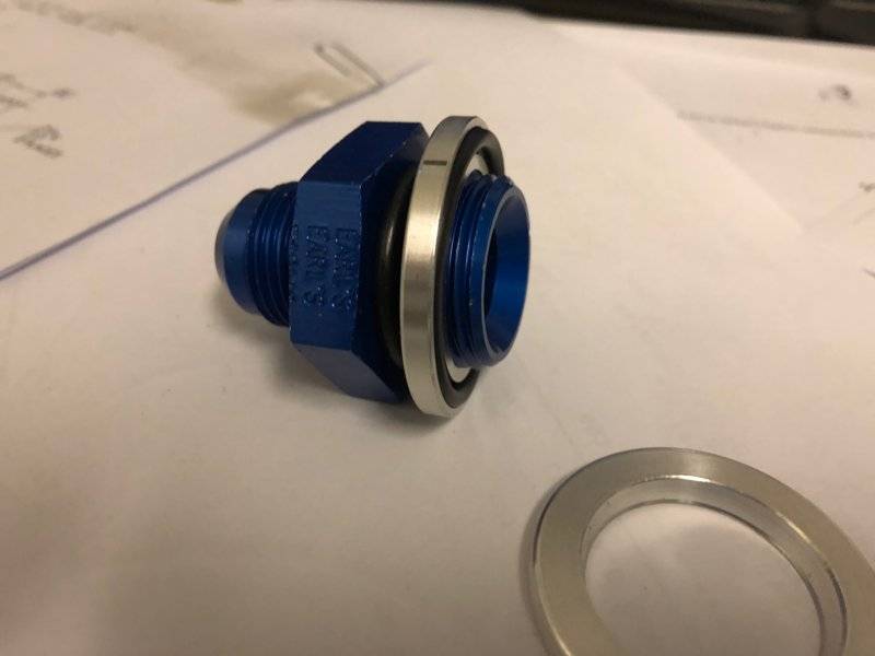

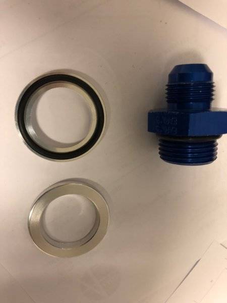

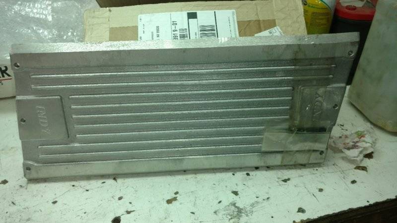

should have asked about our bulk head washers when you ordered your girdle kit. we have them with a double o ring so they seal both the inside of the pan and the outside of the pan.
Please tell me about 'em - not exactly sure what you mean.
here are the bulkhead washers we make. they provide a dual oring seal on the oil pan for zero leaks. each o ring is contained in its own groove so there is no extruding and no weeping forming a perfect seal.
Those look real NICE! I used the white nylon to go with the o-ring on the an fitting that comes out of the pan.

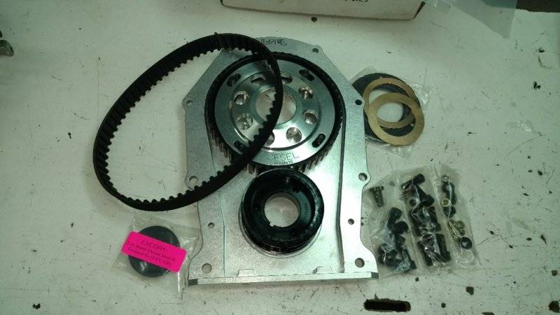

Not much of an update but I got my Jesel belt drive system on Friday. This is one item that I probably could have done without but it's something I really wanted for this build.

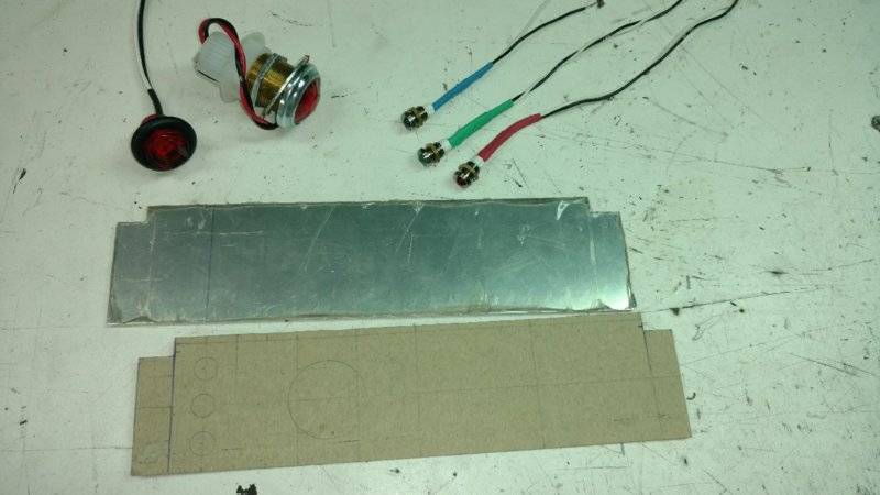

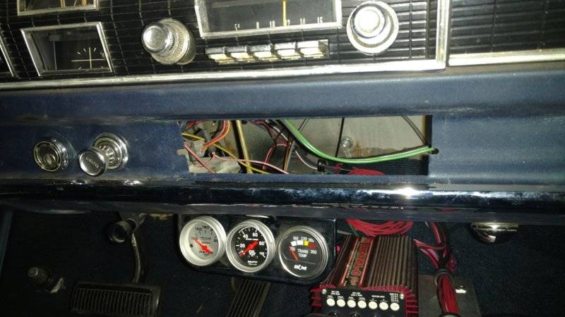

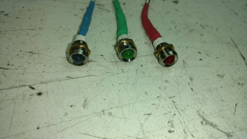

This car was originally equipped with A/C and this hole in the dash housed the center A/C vent. I have removed it and I'm going to install a panel to hold some indicator (idiot) lights.
I made the panel out of aluminum and I'm still figuring out how I want to lay it out (cardboard pattern) It'l have a large oil pressure lite, and 3 small LED's. One for fuel pump (blue), one for water pump (green) and one for charge (alt) indicator (red)

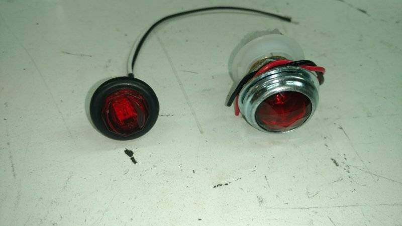

Still have to decide which O/P light to use - the one with the chrome bezel uses a incandescent bulb and the other one is a LED that is normally used as a marker lamp for semi trucks and trailers. The LED is much brighter.
Hello theman440 wondering how are you planning on running your oil pressure light, I need to do the same thing on my 65 satellite, also where are you purchasing those lights?, thank you in advance, Jay.
For the O/P I plan to use a 20psi n/c switch to supply the ground to the light. The positive side to ign "on", So anytime there is less than 20psi the light should be on. The larger O/P light I've had for years and I can't remember where I got it. I've decided to use the smaller LED - you can buy them from any Semi truck parts/accessory store.
Link to O/P switch - https://www.summitracing.com/parts/qcr-61-735
I got the small LED's from McFadden Dale
