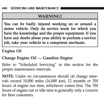

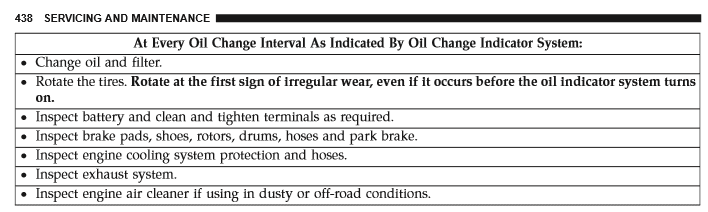

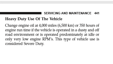

From the 2019 Jeep GC Owners Manual as I read it, looks to me you're due for a change...….
1) when the confuser tells you on the display, or
2) if you play in the dirt and muck (severe duty) 4K miles, or
3) 350 hours, or
4) but not to exceed 10K miles of normal duty, or
5) 12 months
