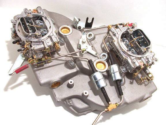

How would or does the Indy intake compare to a Cross Ram in this configuration?

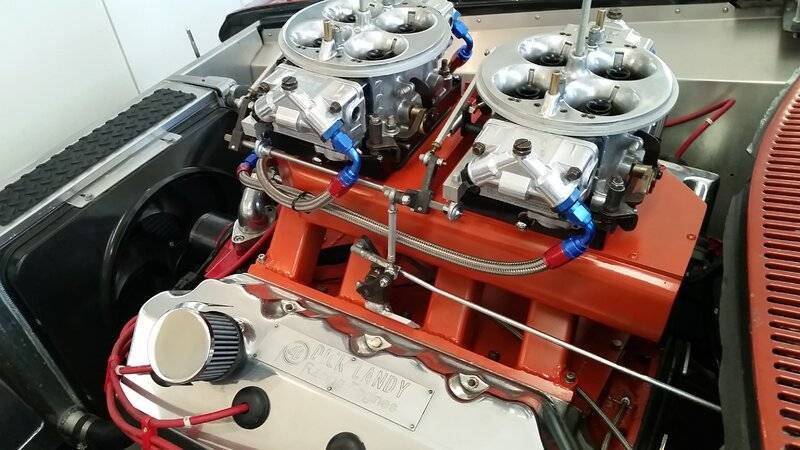

I dynoed a 498 years ago with a cross ram and then the Indy 440-25. The cross ram made 658@5750. The Indy made 710@6750. No other changes. We started the pull at 4000. The Indy was better from the start. and gained 1000 RPM

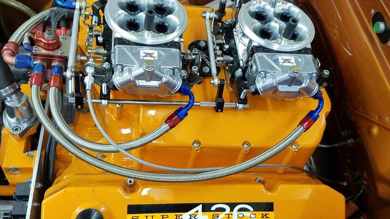

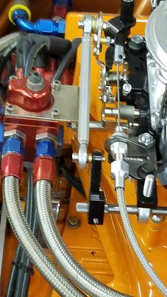

a mate with a chv 409/540 has twin sideways holleys with the full tunnel ram girder linkage , i showed yours as an idea . It should reduce some effort . Just have to check cable length or god forbid buy a lokar one

Hard numbers comparison. I figured so much but not that much of a gain. I'm refurbishing a 1963 Factory Super Stock. I'd like to keep the appearance of a period correct day 2 car. I have been collecting parts to build a street car that might see some track time grudge racing to but nothing organized. Tenths of a second for what I'm intending the car to achieve might not be as important to me as someone who is seeing more dedicated racing.

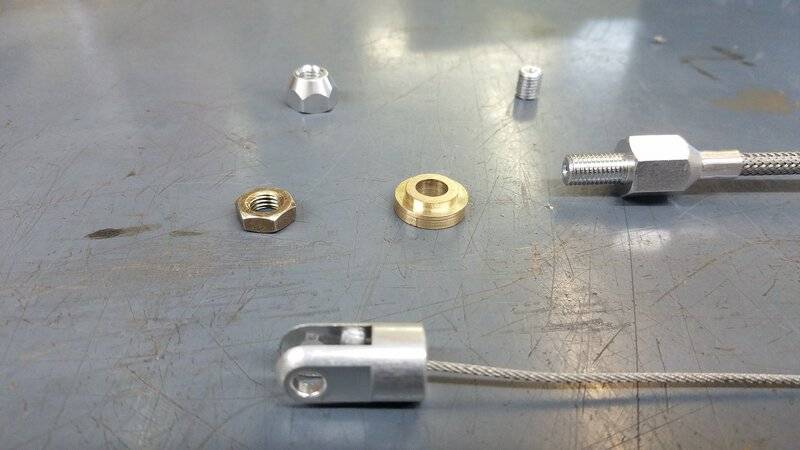

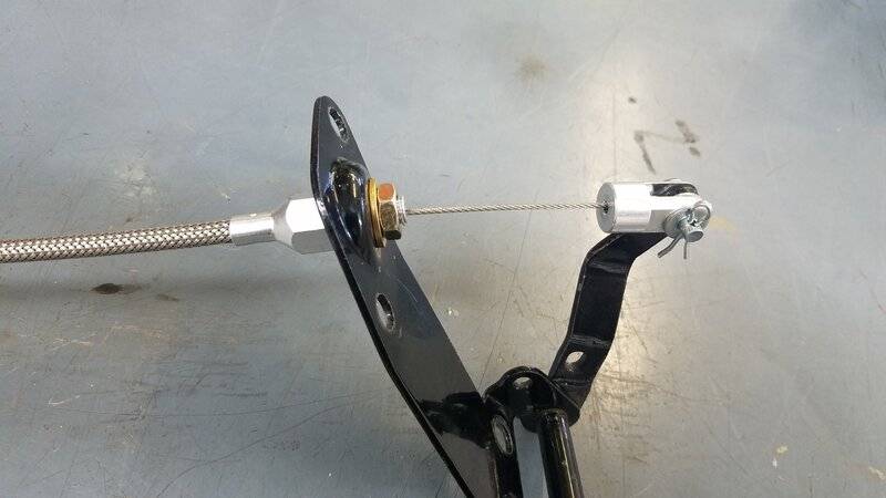

The cable shown is a $22 E bay special. With few mods shown below, it fit fine. The brass spacer was made from a fuel line fitting. Then part of the threaded end was cut off so it was flush on the pedal side. Used a thinner nut as well. The quality looks pretty good. The inner core is .060" compared to the factory .063". It is much more flexible. I cut close to 8" off from it. As for Ten Five o's cross ram question. My former car almost always ran the cross ram dynoed above 10.30s anywhere, best of 10.15.
