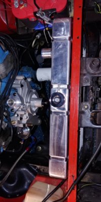

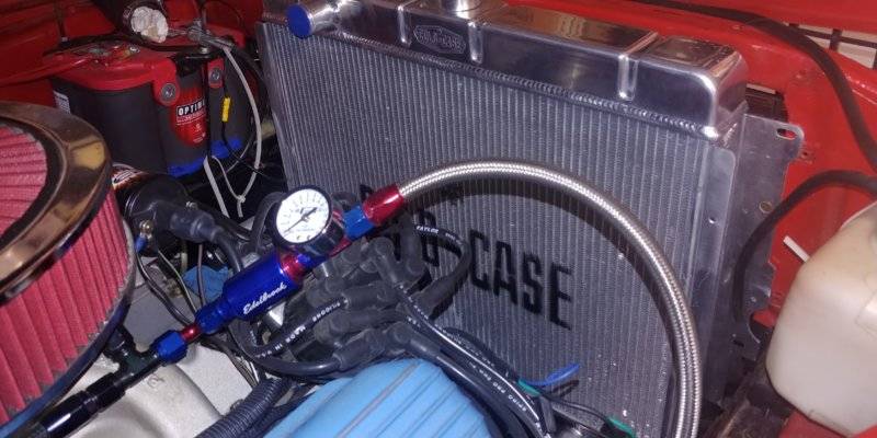

Hey everyone, I have a new situation i'm running into as I complete my fuel and cooling upgrades. This new cold case radiator is a tank! Nicely built and looks awesome. I got the dual elec fans to go with it.

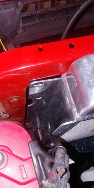

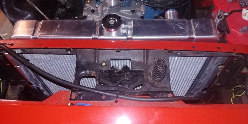

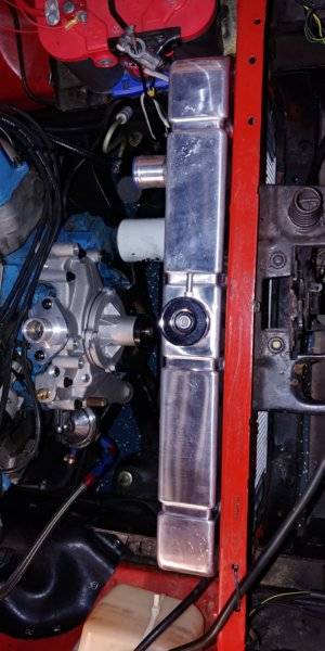

The issue i'm running into is the brackets that came with the radiator are about a total 2" narrower than the width of my radiator opening. After researching online through other sites, this radiator is pretty standard for size. I'm starting to think the radiator supports are not original. The width is 28.5" wide with the bolt holes nearing 31" wide. This radiator itself is measured out at 29" wide including brackets.

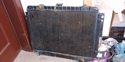

The old radiator is not OEM and it's not even the right era from me posting it on here a couple months ago.
So the question is, do I just go get some aluminum strips to close the gap and do some extensions, or am i missing something?

What year do you have? That original radiator looks like a 1973 and newer 28" unit. Can you confirm the length?

It's a '73. The old radiator has a core of 26 3/8" across, with a total width including brackets of 31.5". It's an odd shape. When i research radiators for this car year, they're all coming up with the sizing of the radiator that i bought.

Radiator mounts directly to the support. You put one bolt in on the lower side, slide the radiator bracket onto it, then install the other bolts. Looks like your support is good, you should NOT need any additional brackets. If so, that radiator is no good.
I believe there was a 28 inch radiator In 1973. My guess is your car came with one, and the new radiator is a 26 inch. You could make it work, as long as the hose nipples are right, or you could send it back.

Ok, from what I can see, you probably originally had a 28" unit in that 1973. We are currently working on a 28" mopar unit because of these forums. You could return that one for a refund or exchange it for the 28" model when available.

Whats the rough time frame for yall finishing the 28" units? I may just make this unit work. Was thinking of going to a local fabrication shop and getting some 3-4" wide strips of aluminum to drill and bolt to the radiator supports, and then bolt the radiator to those strips. Thoughts?
