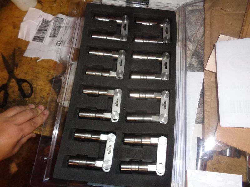

Hello,
Looking for some help. Rebuilding a 440. Comp cam, erson 1.6 roller rockers. In switching to Comp hydraulic roller rockers they were about 1/4" taller than the original hydraulic lifters. Got longer pushrods from Smith Brothers. In setting up and adjusting the rockers, all good. Next time through started seeing readjustments necessary. Pulled the lifters and several were either partially collapsed or cocked. Noticed the box cam kind of beat of the lifter came in and only one set had the blue fish net wrap.
Thank you in advance for any help.

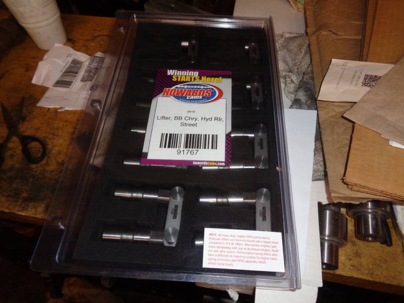

we are using howard's , in your 440 roller build . my cam grinder got them . no beat up box here .
Sounds like something that got returned and shipped back out without inspection.
Where did you buy them?

What part number lifters did you buy?
