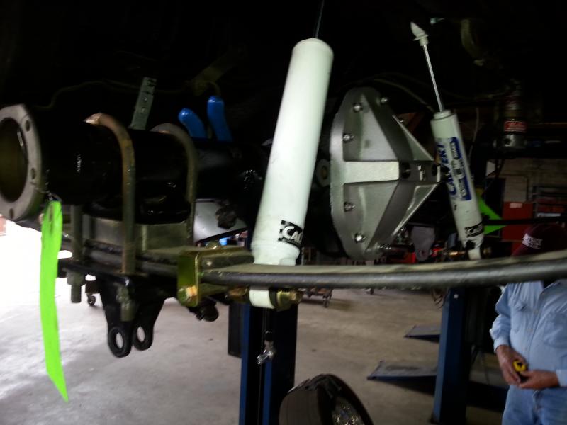

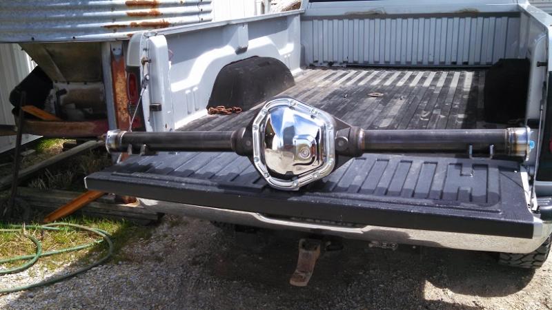

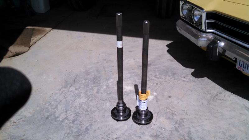

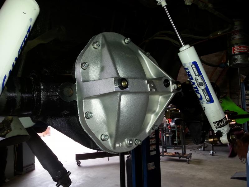

Dana Install is about done at the shop. Just need to install the axles and brakes and then shorten my driveshaft then hook up the Cal Trac Bars, etc.
For my fellow MOPAR RACERS it cost me $2756.00 complete for the DANA. All MOSER parts...35 spline axles, 4.30-1 Spool. Used my drum brakes installed on the DANA housing. Price included all labor, new brake lines, etc..turnkey price

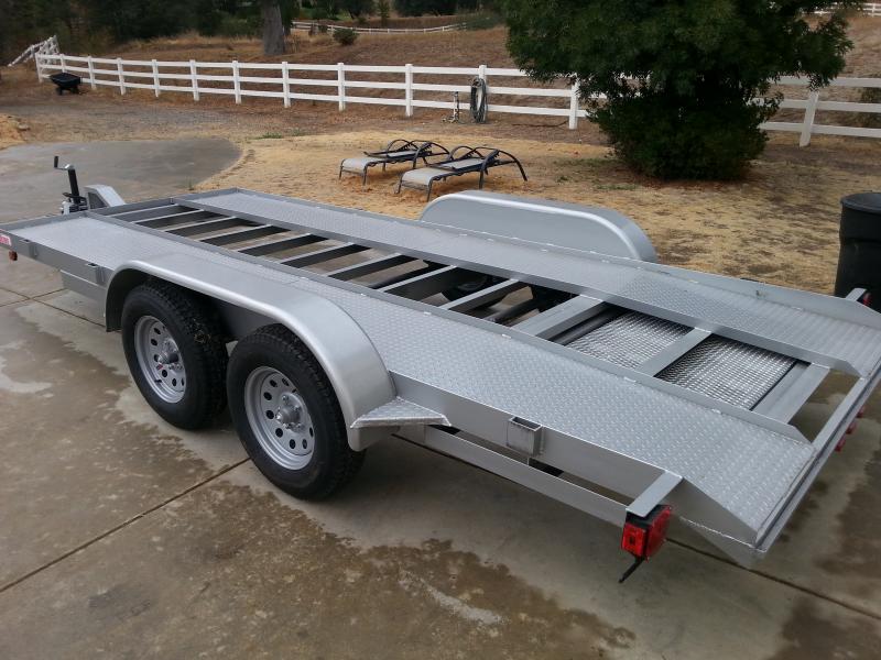

Sweet looking trailer how's it pull ?
Where did you get the Dana from Mike? Nice trailer
said it's from Moser .
Bobtile. I got mine in the 65 Plymouth from there too. Very nice Mike. Good luck
Cool! And my open trailer is similar only the runners are wood but will probably replace the wood with diamond plate when the time comes.
Mine from Moser as well. I paid a little more because we opted for the Detroit tru trac.
Bobtile,
All the internal parts and axles, etc are from Moser...but the housing is NOT Moser, but from a donor 1 TON PICKUP truck from the boneyard, which I paid $200 for.
I am NOT bleeding money, it is now all gone ... lol.
Trailer pulls great.

Hey Mike, are you using the truck drum brakes on there? They are pretty heavy.
I am having the shop transfer my drum brakes from my 8 3/4. As you probably know Moser sells axle "tips" which have the regular 8 3/4 MOPAR backing plate pattern on them. Then the shop welds these axles tips to the narrowed DANA Truck housing.
Question Mike - how much do have to shorten the driveshaft?
As of right now I do NOT know how much they had to shorted my driveshaft. They do have to shorten it because the DANA Center Section sticks out from the rear end more than an 8 3/4. I will know how much they shortened it when I pick up the car tomorrow and will post it here.

Make absolutley sure you order the spring perches exactly right or otherwise the pins won't line up with the holes.
Or you could not have the spring perches welded on and then weld them on yourself or have a shop do it...ask Moser the best way, in their opinion.
