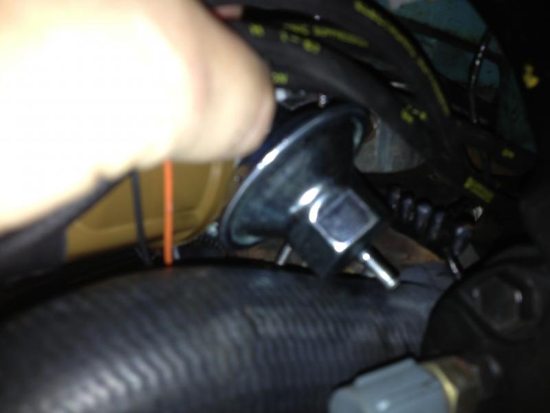

I have a 1967 Cononet 440 A/C equipped car, and I decided to update the distributor with a Mopar Performance electronic unit and install went great. The issue is i cannot rotate the sucker clockwise enough to time it due to the upper radiator hose! I'll post a PIC of the nut-buster! IMG_2068[1].jpg
Turn the engine to TDC on cylinder 1 on the power stroke. Pull the distributor out and take a large flat head screw driver and stick it in the slot, turn it (clockwise iirc) so that the oil pump shaft will drive itself up off of the cam gear. Turn it further back to get the slot oriented whatever way you need to set the distributor to number 1, and turn it back so that the gears mesh back together and it fits back correctly. Reinstall your distributor and set to fire number 1.

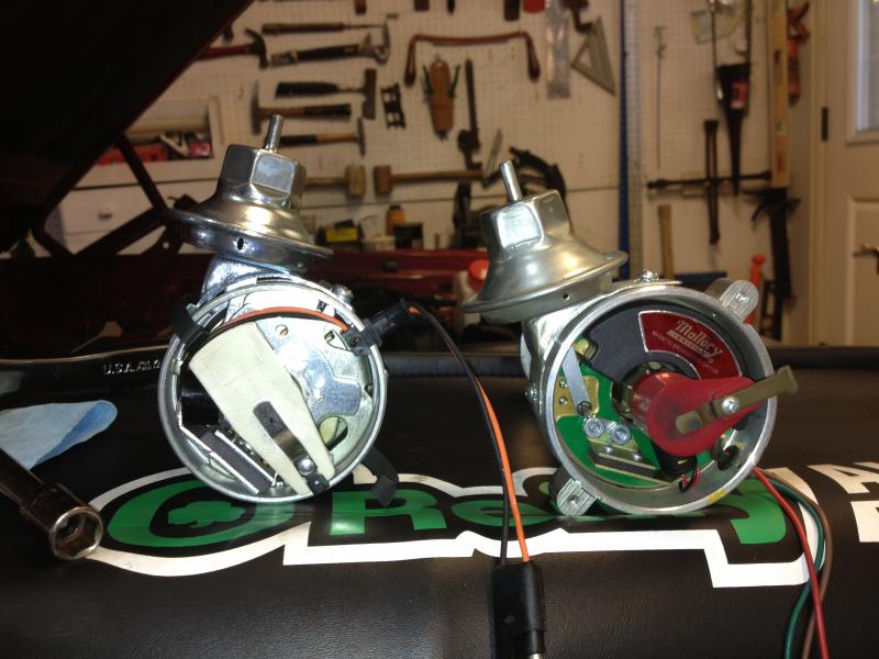

The Mopar Performance unit on the left and the Mallory on the right both had a similar issue. So I guess moving the gear clockwise one tooth may help? I'll wait for a reply.
If the engine is at TDC in that picture your problem is just that the oil pump drive is in wrong (not that it matters from a mechanical standpoint but from the standpoint of the vacuum advance can fitting where it should). At TDC the slot in the drive should be perpendicular to the crank. Give that a shot and see if it works for you.
Matt was telling you to turn the gear with a screwdriver clockwise to get the gear to walk up and out of the cam gear. Watch the gear come up and out as you do this. Keep track of the teeth as the gear seperates from the cam. Don't loose your place on the gears. I'm thinking you need to reinstall the gear counter clockwise one tooth from where it is now,to get your distributor to go that direction to give you more space between your vacuum advance and hose. You think about which way you have to go to relocate the distributor. Check back if you need more clarification...

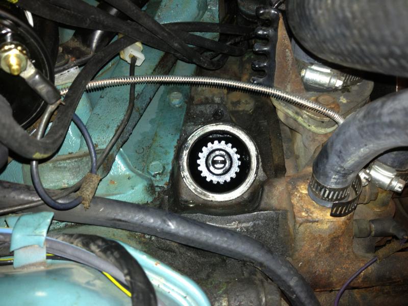

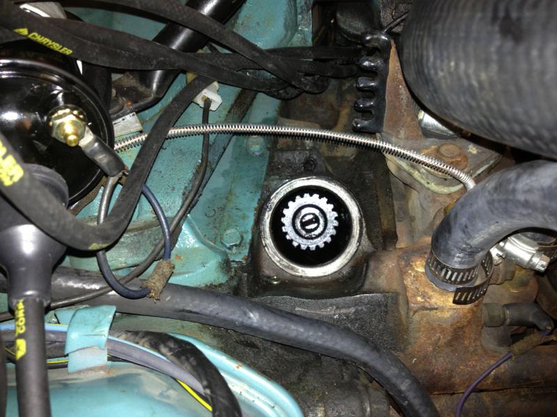

Ok, here is the TDC view of the gear. I have gotten the balancer-notch to line-up and the gear should be at a 45 degree angle to that, so mine appears to be parallel.2013-08-29 16.00.53.jpg2013-08-29 16.01.03.jpg
Clock it so that its perpendicular and give it a shot
