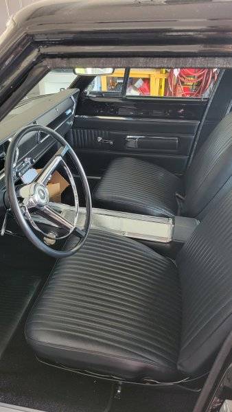

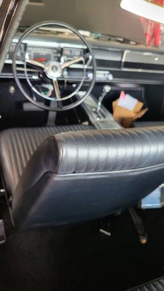

I've acquired parts over the last two years and finally had a local shop install my new floor console and shifter. My car was originally a column shift, but the previous owner converted it to a floor mount B&M ratchet shifter. It worked fine, and I liked how it looked, but I really wanted a more OEM look for the interior. I think I was at around $2000 in parts by the time I was ready. The shop I used spent 20 hours installing, which was a bit of a shock, but I love the finished product. Maybe they overcharged me, maybe they didn't, but I want to let everyone know who might be considering this conversion that you will need to weld the console mounts to the tunnel and cut the new hole out for the shift linkage. They told me it wasn't an easy job, and since my car is a Mopar, I couldn't argue with them. Here are the before and after photos:

Yeah, they said there were a lot of mockups, so I guess I can see how this would take so long. I should also note that when I first went to pick up the car, I noticed the console was leaning to one side! I was mortified and insisted they make it level so they put some shims in and leveled it out. It cost 3x what I originally thought, but as I said earlier, I am really happy with the end result. Shifting is smooth and easy now, and it looks GREAT!

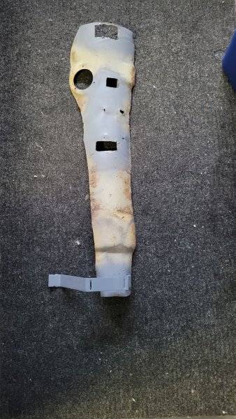

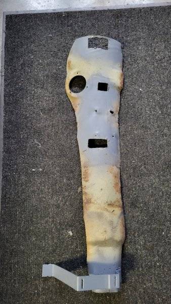

They told you it was not an easy job? I used a floor section from a b body. It served as a template for the shifter hole, and the console brackets. I riveted the brackets in place, and welded them. My first time doing that conversion.
I did this conversion myself. I lucked out because i have the small floor section with the shifter hole, and brackets i used as a template. The shifter provision was there with the three dimples for the purpose of drilling holes for the shifter boot, and retainer. The rear floor pan under the seat had the provision for the exhaust hanger. 67 belvedere with 383, hipo exhaust manifolds, and accurate exhaust system.
