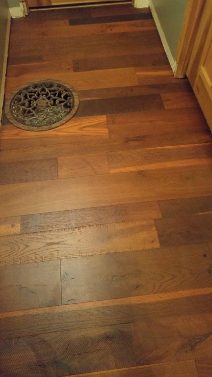

To give a little hindsight my wife and I built our home and wouldn't you know it I got laid off during the construction leading us to save where we could.... the floor. We had some Red Oak laying around and had it milled into a hardwood floor and I've hated it every since! When the wife pitched the idea of replacing it I was all for it except ripping up the tile too, we compromised on a floor I really liked with the agreement that the tile would go.... Bad idea!!!!!

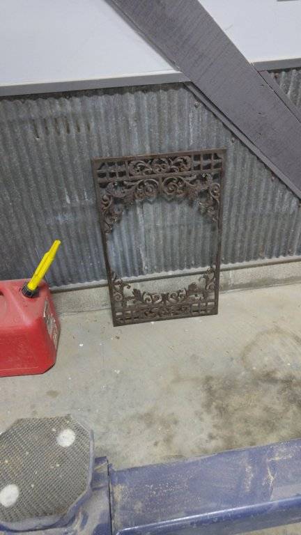

So where it went wrong... I didn't like the fresh air return so I decided to rework it... Took the huge rectangular grate and cut a circular pattern out of it and whipped up an Oak trim ring.

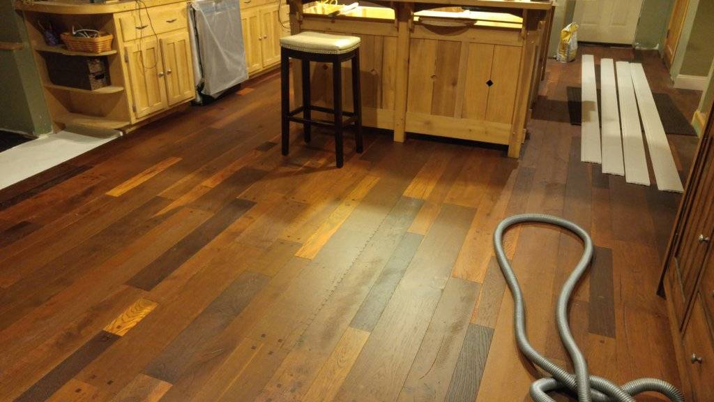

Next problem was the transition (stairs) from the kitchen to the living room. Since the living room was added after the kitchen the stairs were built to mate to the old floor.... Had to be gutted and reworked.
Then as I'm pulling up the old floor I find the dreaded termite damage!!! Fortunately it's very localized, there's a inaccessible crawl space that has a cold joint in the concrete allowing them to get threw. As it turns out they focused on a piece of dead flooring (dead prior to being sawed) and a joist in the crawl space and nothing else.. That I can find.
The killer was ripping out the tile that I initially refused too do, what a PITA!! Whoever says thinset mortar doesn't stick to wood is full of chit. 2days renting tools to find out that a chisel on our Bosch Hammer drill was the ticked and that's just to get the mortar up after the tile and backer board was already gone!

I allowed 2 days for this and am now on day 5 but couldn't be happier with the results even with the setbacks.

Looks Real Nice Dev!
Now is the time to find a friend with a pesticide license and drill the outside foundation and put terminte control to work. You will need the powder and liquid.
Looks like a whole "new" house . . . and you've finally gotten rid of that oak flooring that you didn't like to boot ! !
Big bummer on the termites . . . at least it's a very small area . . . The kicthen looks AWESOME ! ! !
Well that ate up your week off in a hurry! Sounds like it's been fighting you the whole way!
I know the granite counters were in the future plans anyways but sucks when you're forced to pull the trigger early.
The new floor does look phenomenal though can't wait to see the complete finished product.

There is ALWAYS something that causes a fairly straight forward project to "snowball". I like the floor, how it looks against the cabinets, and your creativity with the round vent cover. Press on Brother!

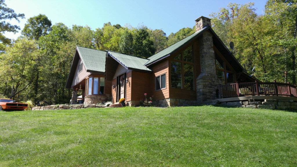

And here's a picture of my house that I'm working on . . . The windows in the radius area is where the footer is
